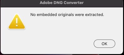

Ian Lyons
January 14, 2022
This leads me to think that the demosaiced information in a "raw details" DNG ("Enhanced") is stored along with the original raw data, and that it remains lossless/raw information until the image actually gets flattened (or rasterized).
The demosaiced information (i.e. the original raw file) does not appear to embedded in the 'Enhanced-DNG' file. If it is, then it would be easy to extract same using the DNG Converter 'Extract' option, and having just tried it, I get the following.

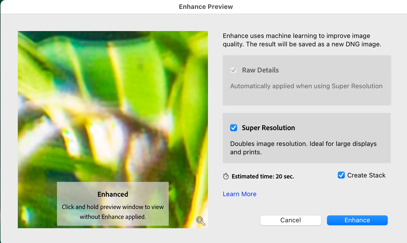

DdeGannes
January 13, 2022
See the screen capture when you use the "Enhance" feature in LrC with a RAW image file. As you can see from the info in the dialog the is going to be enhanced to produce more detail during this process the number pixels in the hight and width will be doubled, if Super Resolution is chosen, which means the total pixels will be quodrupled. If the raw file is 24 mega pixels the enhanced DNG will have 96 mega pixels.
Regards, Denis: Laptop Win 11, ver 24H2, LrC 15.4 PS 27.8;
