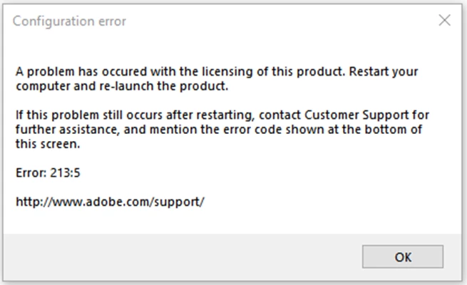

I hadn't used LR for some time but yesterday I had a 'pop-up' message when trying to upen LR6:
So I retried opening it, rebooting the PC and then attempting to open - all to no avail.
Removed LR6 and again tried to open it but with the same message.
