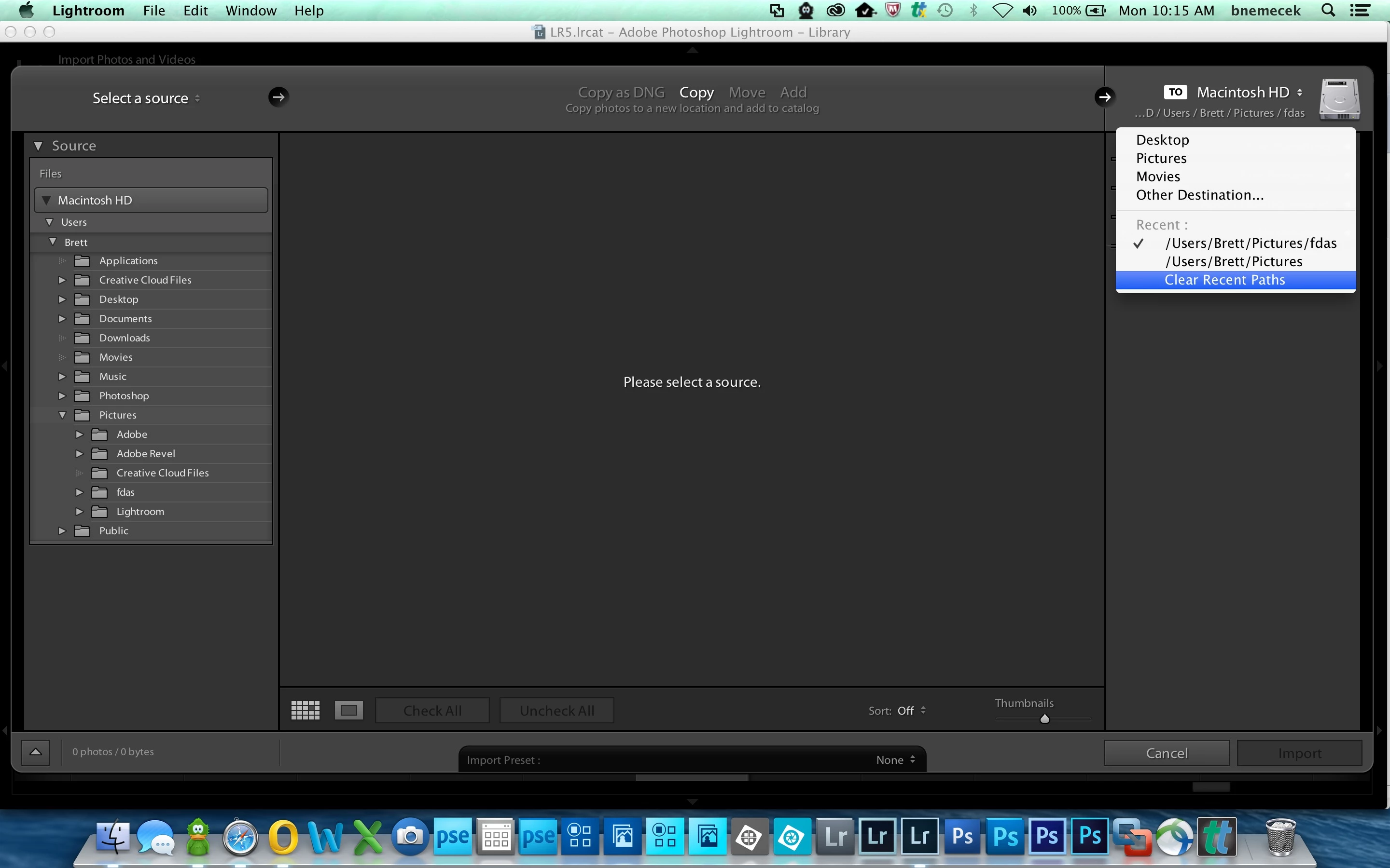

February 24, 2014
Some recent work with someone else indicated that the Recent Folders list in the Import window can cause some strange behavior. The Recent list is tied directly to your catalog, which may explain why a new catalog has made things work here. I'd suggest simply clearing the Recent Folder list in the Import window to remove any bad entries which may be causing an issue. Use the Clear Recent Paths command to remove these items.
