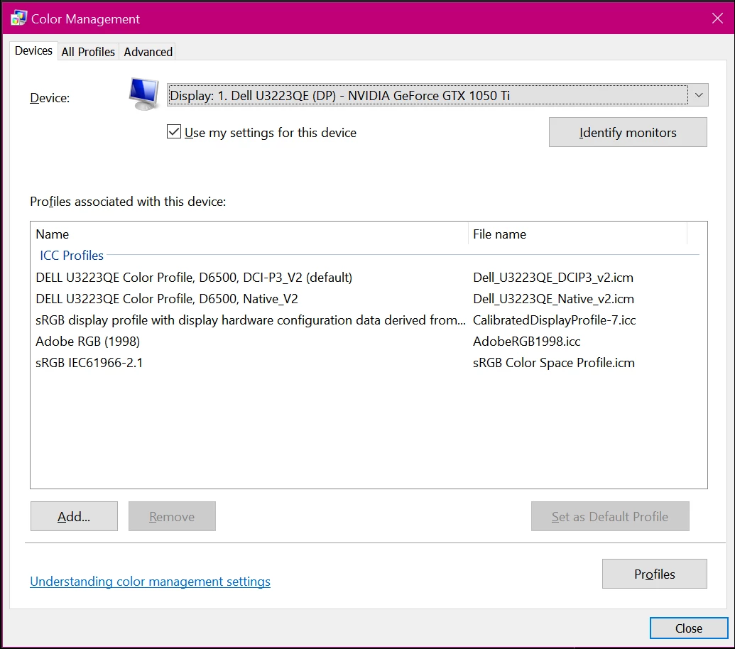

Feb 1, 2025 11:22 PM UTC
Thank you, I have tried this!
Soo... I did not have any DCI-P3 option in my window except the Dell one which was the current default, however, I found an interesting one called "CalibratedDisplayProfile-7.icc" and I tried that, and it seems to have fixed the issue.  The colors render the same in both modules, and they look good to my eye (not too saturated or too dull). Could this be all I need to do? (Yes, I did click the "Add" button, and there were a lot of others, just none that said DCI-P3). I will try to attach a screenshot

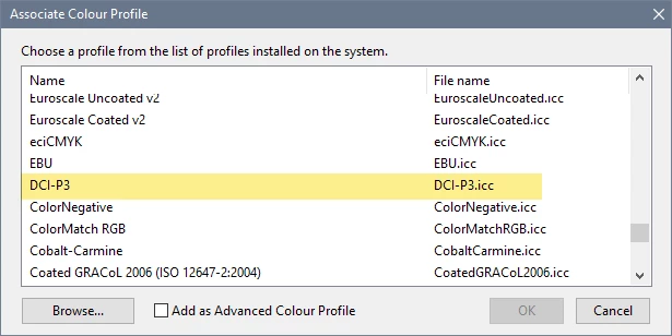

Feb 1, 2025 11:43 PM UTC
The DCI-P3 profile should be there. You have to scroll down quite a bit, the profiles are listed in reverse alphabetical order. You could also use Adobe RGB. They are both better than a Dell profile.
