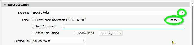

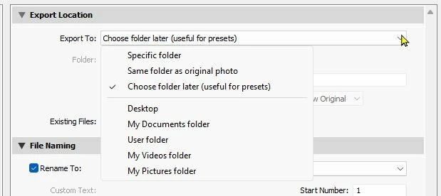

In your Export dialog, which of the options do you have selected?
Is it this one?-
If you have the option set to "Specific Folder"-  Does that folder still exist in the exact same path as it did BEFORE you re-installed Windows?

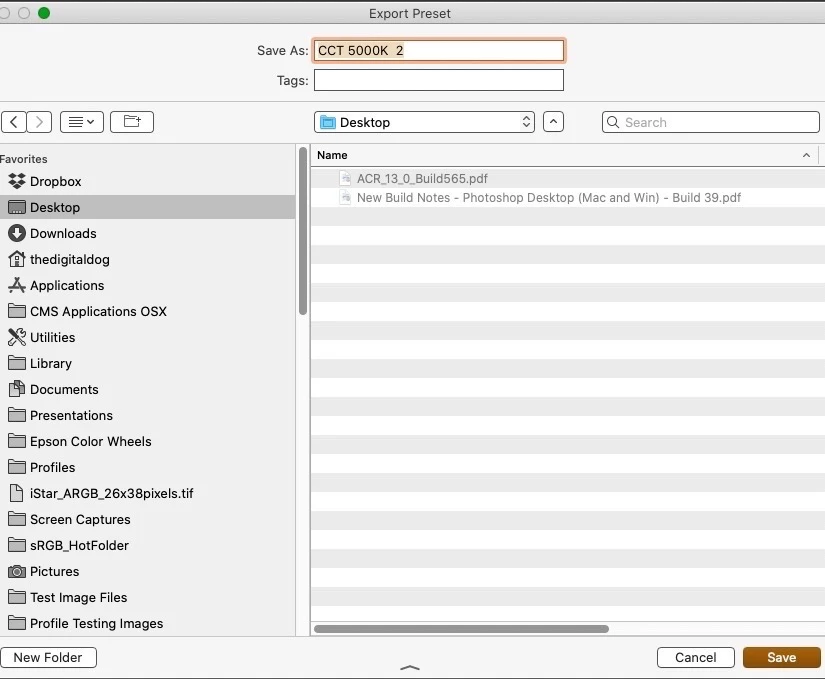

TheDigitalDog
Aug 25, 2020 6:37 PM UTC
So when I use Context Menu, select a User Preset and select Export... the location is sticky; the last place I located for such a save from LR (not necessarily from another application also locating to a folder):
