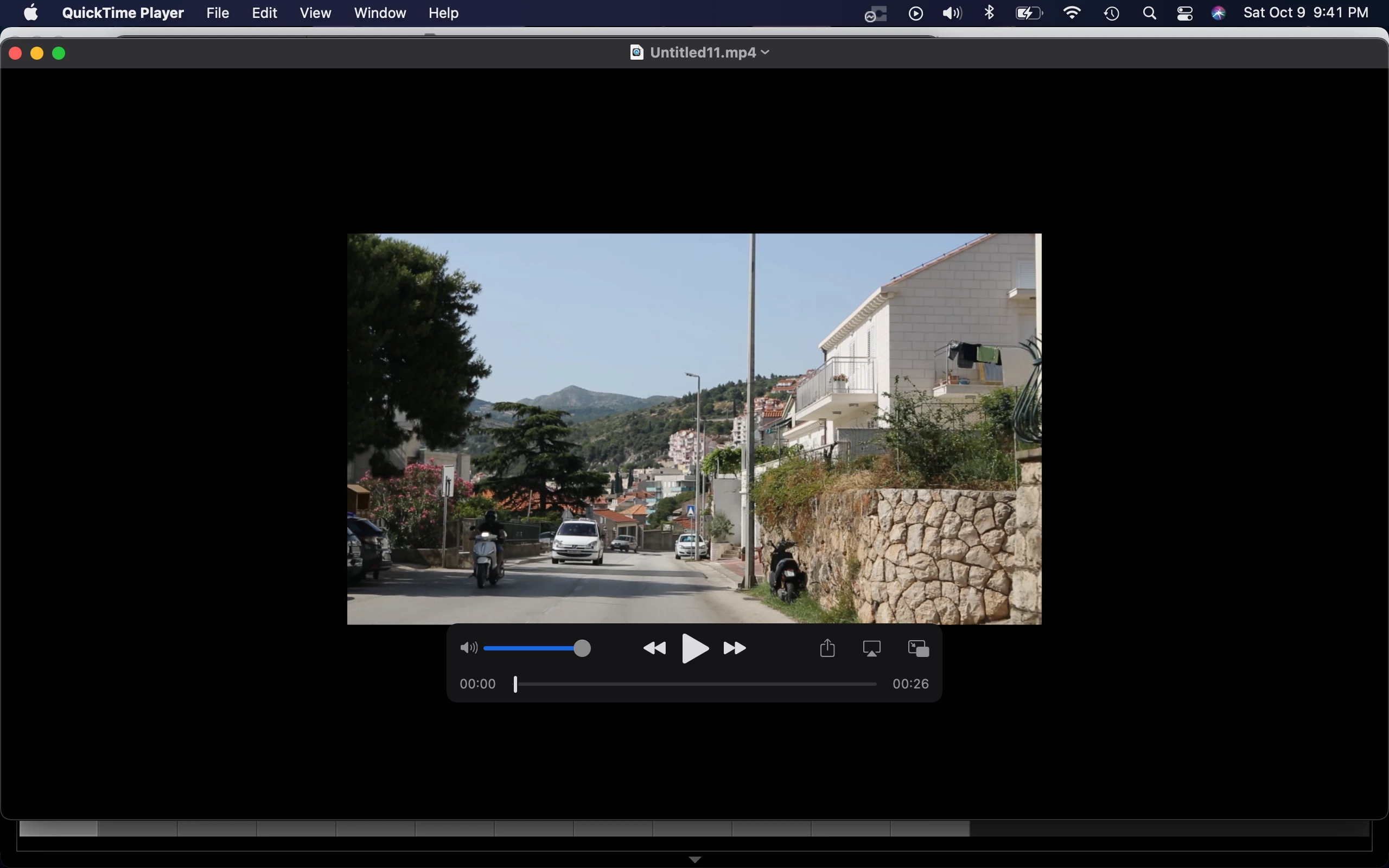

I've created a small test slideshow three 1080p videos and a few images.  I use the built in Widescreen template for the slideshow.  I am expecting that an exported video of the slideshow would show the 1080p videos filling the screen.
When I play the slideshow, the videos are surrounded by black areas instead of being displayed full width.  When I export the slideshow to video at 1080p, the videos appear about half the size of the 1080p video screen, surrounded by even larger black areas than when the slideshow is played live.  If I use the standard Export... feature of Lightroom to export one of the videos to 1080p H264, it fills the 1080p export screen as expected.  I've attached screenshots below of the various views of the video being played and exported.
There is no difference if "Zoom to Fill" is chosen, and no difference if the GPU is enabled or disabled.
How can I get the videos to play at the correct size?  Any suggestions would be appreciated!
Thanks!
Jon
Results of Slideshow "Export to Video" at 1080p:

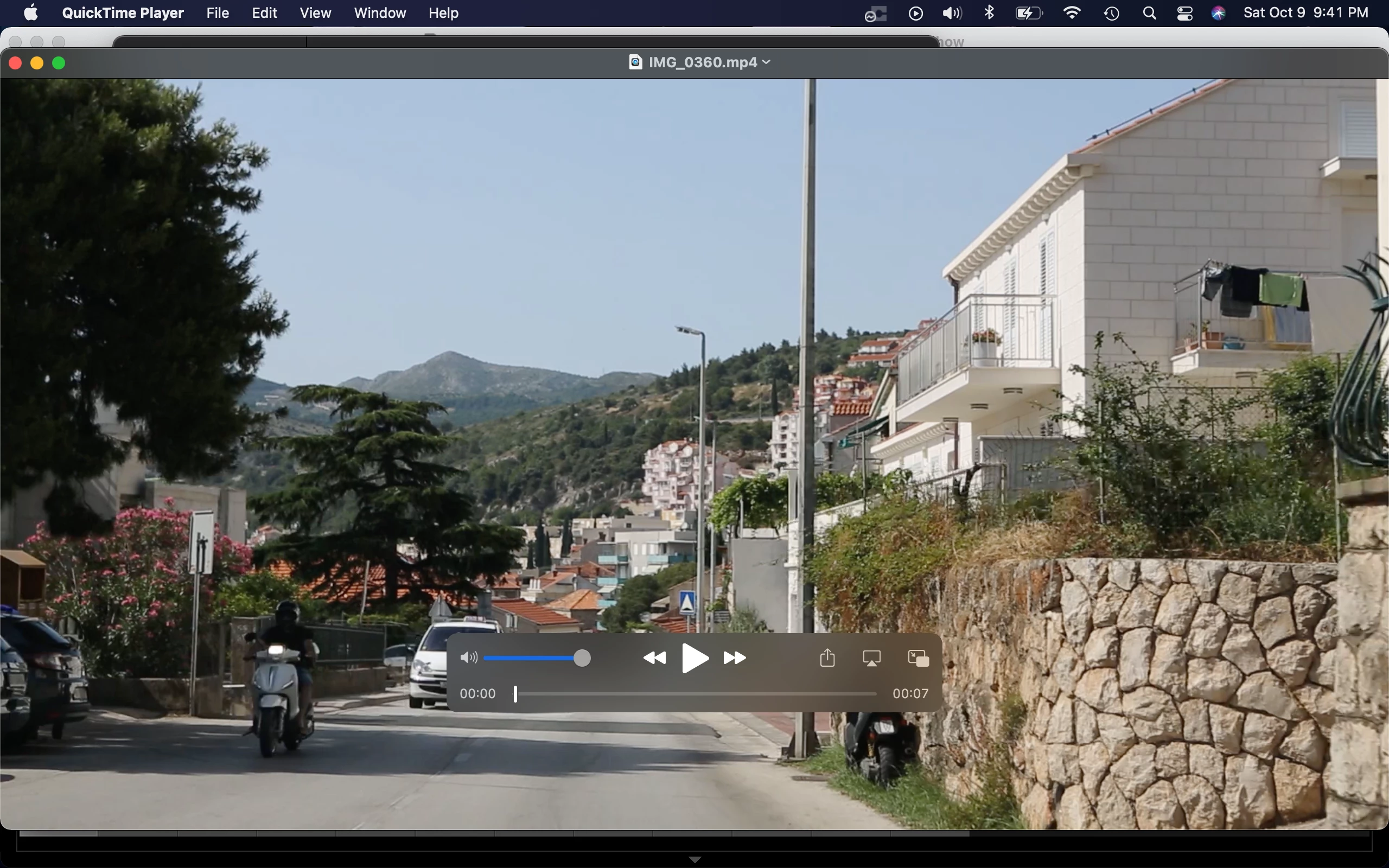

Results of "Export..." at 1080p

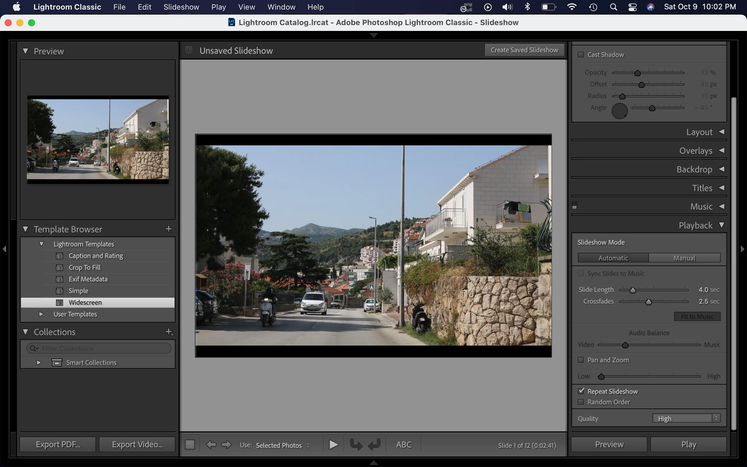

Video appearance in Slideshow Preview mode:

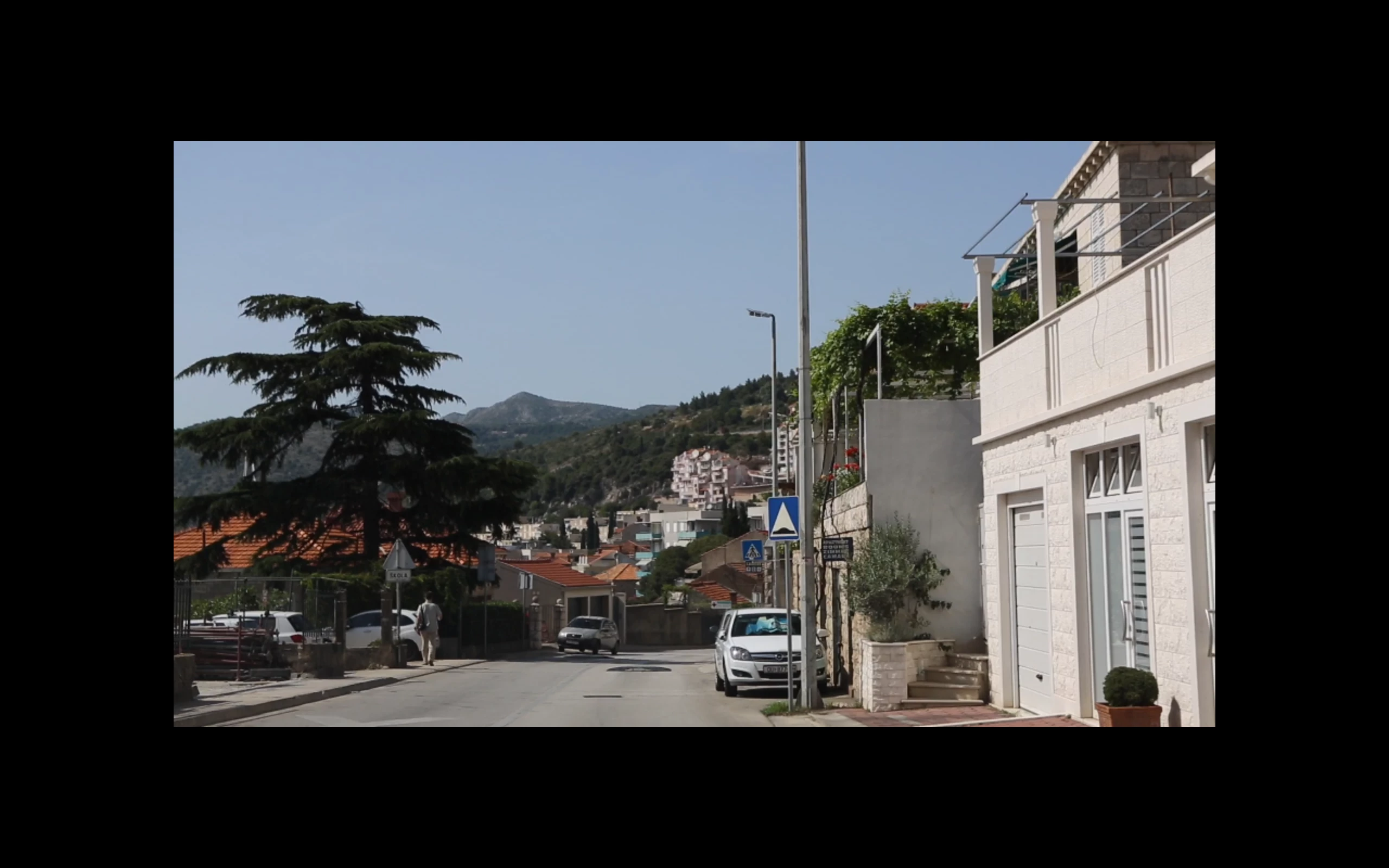

Video appearance in Slideshow Play mode:

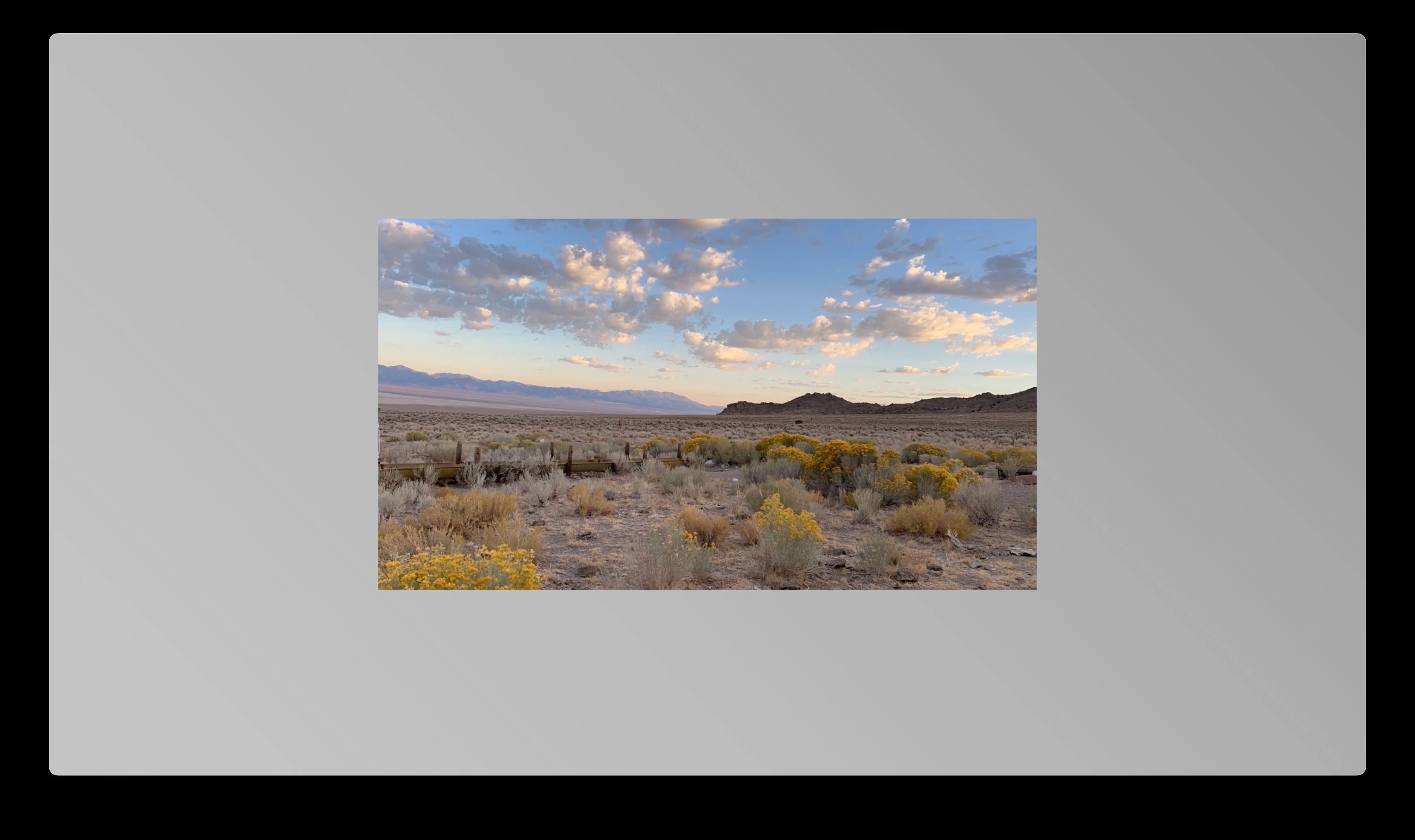

Just adding that in Oct 2024 I'm seeing this as well. This is the thread I found; there doesn't seem to be any solution.
My case:
Slideshow with images and four video clips. Two of the clips are 4k, two are HD resolution. The two HD clips aren't "zoomed to fill screen" resulting in the attached image. Similar thing happened with some of the lower-resolution (less than 4k) still images.
Zoom to fill screen is checked on.
This is Lightroom classic 13.5.1 on Macbook pro 14in 2023 w/M2 pro chipset.
My sense is that the zoom to fill screen does not act on individual files but rather the highest resolution of a specific filetype. Then lower resolution images/videos of the same type are scaled with the higher resolution in mind.
I removed the lower res images (I had lots of alternates) but need the two HD videos.
There doesn't seem to be any solution—way to, say, double resolution of videos so that they appear full screen (albeit perhaps lower visual quality).
