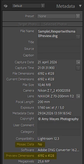

    I downloaded your two DNG files and imported them in LrC, and both report the preview size to be 6192 x 4128.
    Although they open without issues in Adobe applications, other applications cannot open them.
    Windows Photos and ACDSee Home (that cannot read raw files, and display the embedded preview) both have issues with them.
    Photos says that the format is not supported or the file is damaged, and ACDSee just displays a black box. Probably because because they don’t support the format; see Mosaic Data: No in the screenshot. That indicates that this is a linear DNG, not a raw file.
    The files have probably been shot as Small raw – the full resolution for the Nikon Z7 II is 8256 x 5520.

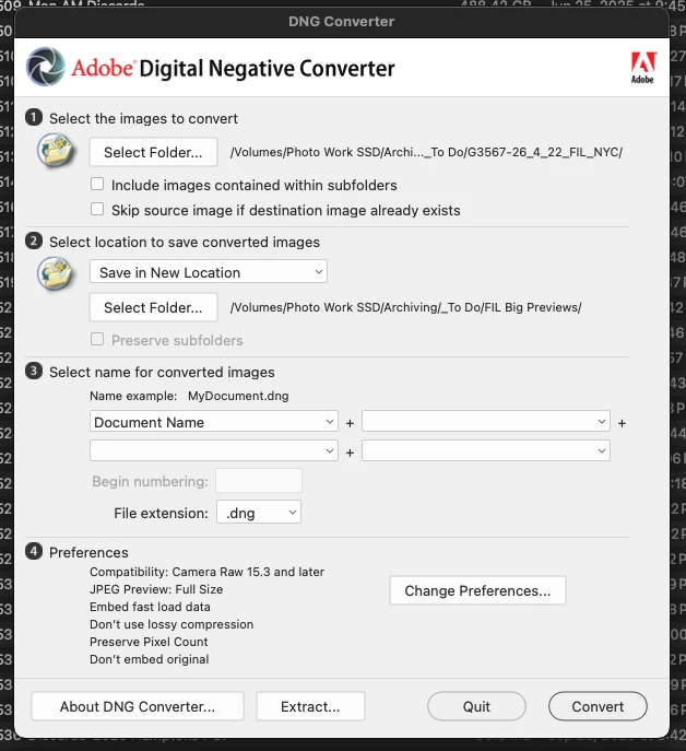

    I am no export in this field, but I do know (by experimenting) that the Adobe DNG Converter will ‘convert’  DNG files to DNG files with the option for Full-size previews, option set in the preferences.
    Give the DNG Converter a go on a Folder of DNGs. (Lightroom-Classic is not involved.)
    Regards. My System: Windows-11, Lightroom-Classic 15.6, Photoshop 27.8, ACR 18.7, Lightroom 9.4, Lr-iOS 10.4.0, Bridge 16.0.3 .
    Apr 27, 2026 10:16 PM UTC
    Not working with this either. Here are my settings.

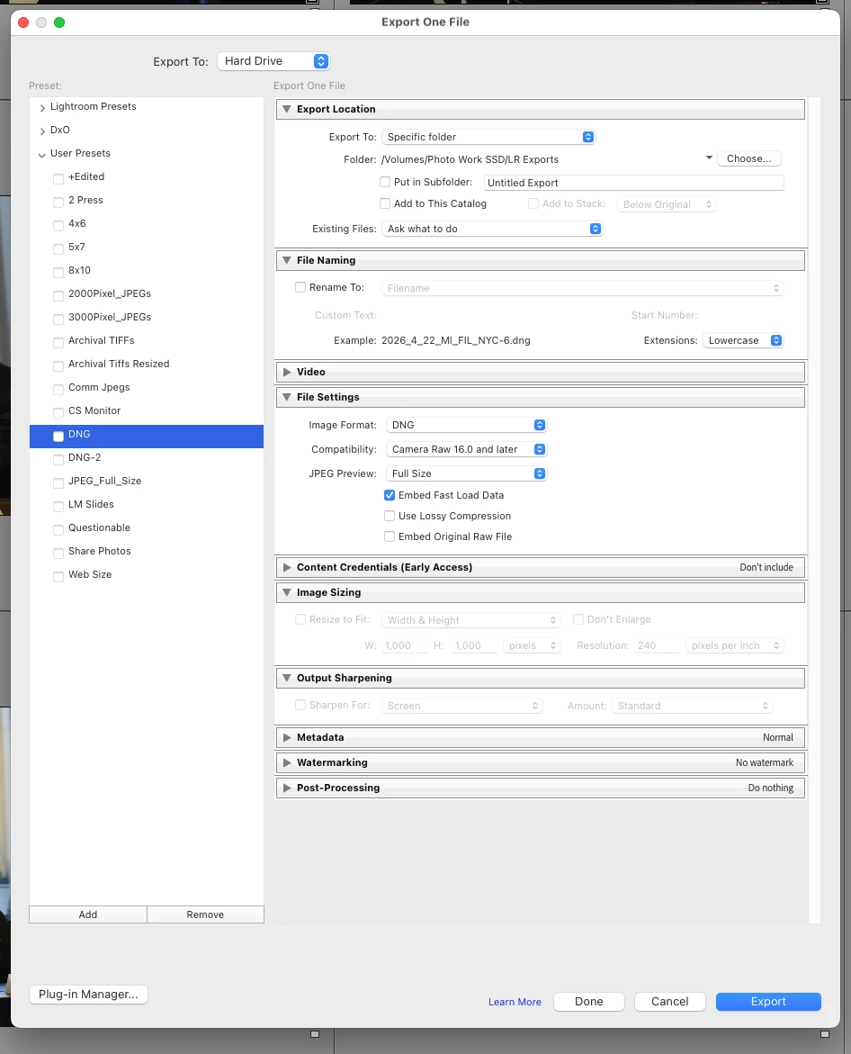

    Apr 27, 2026 10:27 PM UTC
    LR version is 15.1.1.
    Original files are DNG with small preview.
    I’m adding a screenshot of my export settings which are what I use for all of our archived images.
    Mac OS 15.7.4
