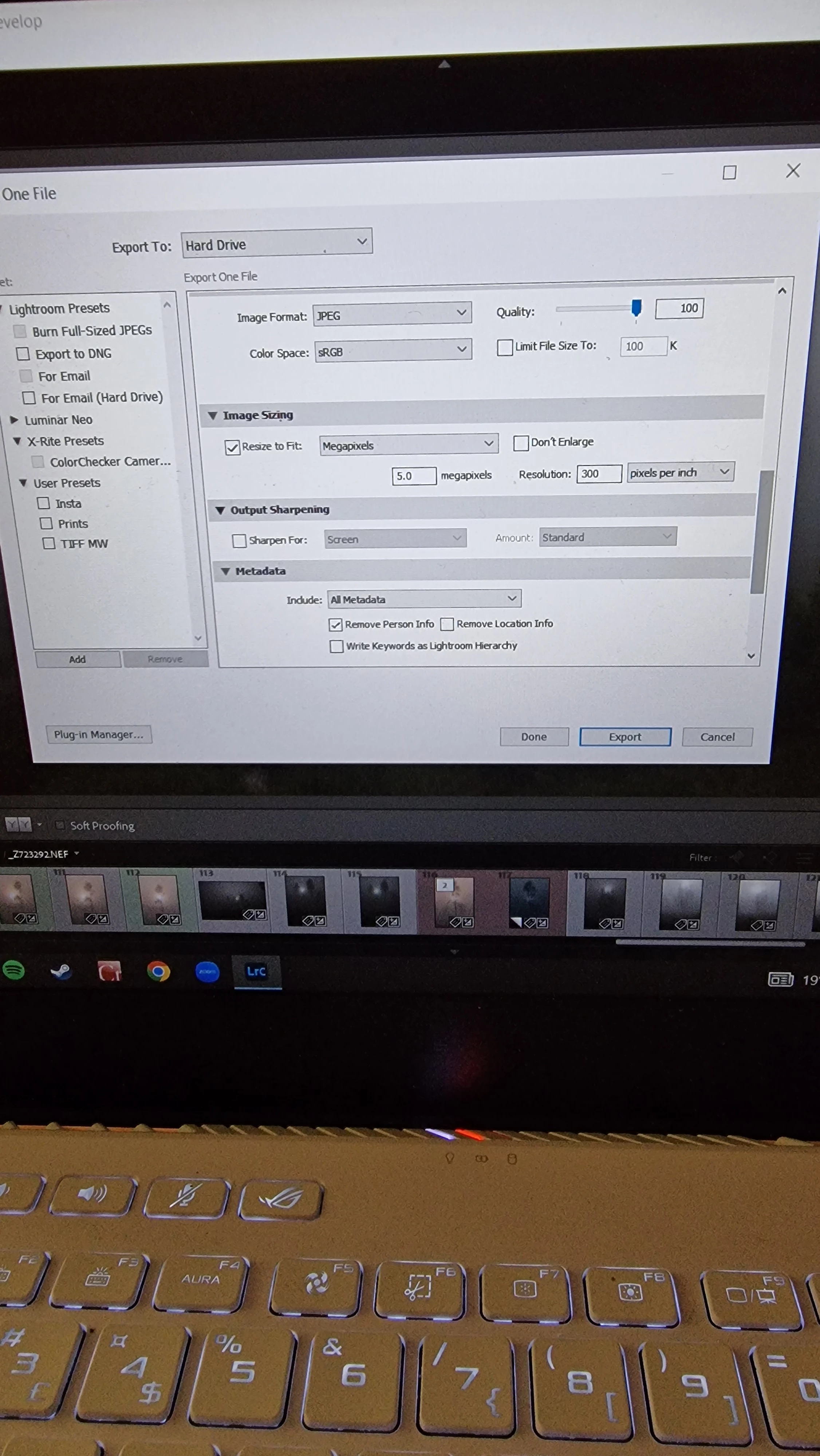

Hi all,
I want to export to an exact megapixel amount in Lightroom Classic, but when I select this option to 5.0 megapixels for example, as shown in my photo, it exports at 1.29mb. I have also tried this by first entering the megapixel amount, then unchecking the resize to fit box but it gives the same size once exported as if it was ticked. Hopefully there's an easy fix here as I dont want to hav to do it with guesswork.
Thanks in advance / G

dj_paige
July 20, 2023
The option you are looking at can somewhat control megabytes and has nothing to do with megapixels, which are two entirely different things. You can't get an exact number of megabytes, REPEATING IN CAPITAL LETTERS CAN'T BE DONE. Furthermore, there is no point in requiring an exact number of megabytes, its wasted effort that solves nothing. So there's no fix, and no reason to perform a guessing process.
As pointed out by @Per Berntsen perhaps you want an exact number of megabytes, in which case he has also explained how to do this.
July 20, 2023
As mentioned to Per, the reasons I want exact MB are for uploading to various places on the Web that require image sizes to be below a certain size, often stated in MB. I'll use his recommended which I know isn't an en exact result in MB but close enough for my needs. coincidentally it was the same I was doing before, albeit trial and error and I wondered if there was a more accurate way, which I now understand there isn't, so trial and error it is which is fine

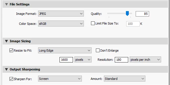

Per Berntsen
July 20, 2023
Megapixels and megabytes are not the same thing.
The number of pixels in an image is measured in megapixels (millions of pixels).
A 6000 x 4000 image contains 24 million pixels – 24 megapixels.
So when you set Resize to fit to Megapixels and 5 MP, you get an image measuring 2778 x 1800 pixels, if image proportions are 3:2.
The space an image takes up on disk (file size) is measured in megabytes, which has no direct correlation with pixel count.
Several factors influence file size – pixel dimensions and bit depth, and for jpgs also compression ratio and subject matter.
I'm guessing that you want to export jpgs with a particular file size, which is not possible, except by trial and error.
You can use the Limit file size option to keep the file size below, but as close as possible to, a particular file size.
This may result in unacceptable image quality, because  LrC might have to use a high compression ratio.
Unless you really want to export in megapixels, set pixel dimensions instead under Image sizing.
I normally use Long Edge, and the short edge will be calculated automatically.
You may find this article useful:
What is a digital image?
