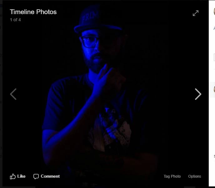

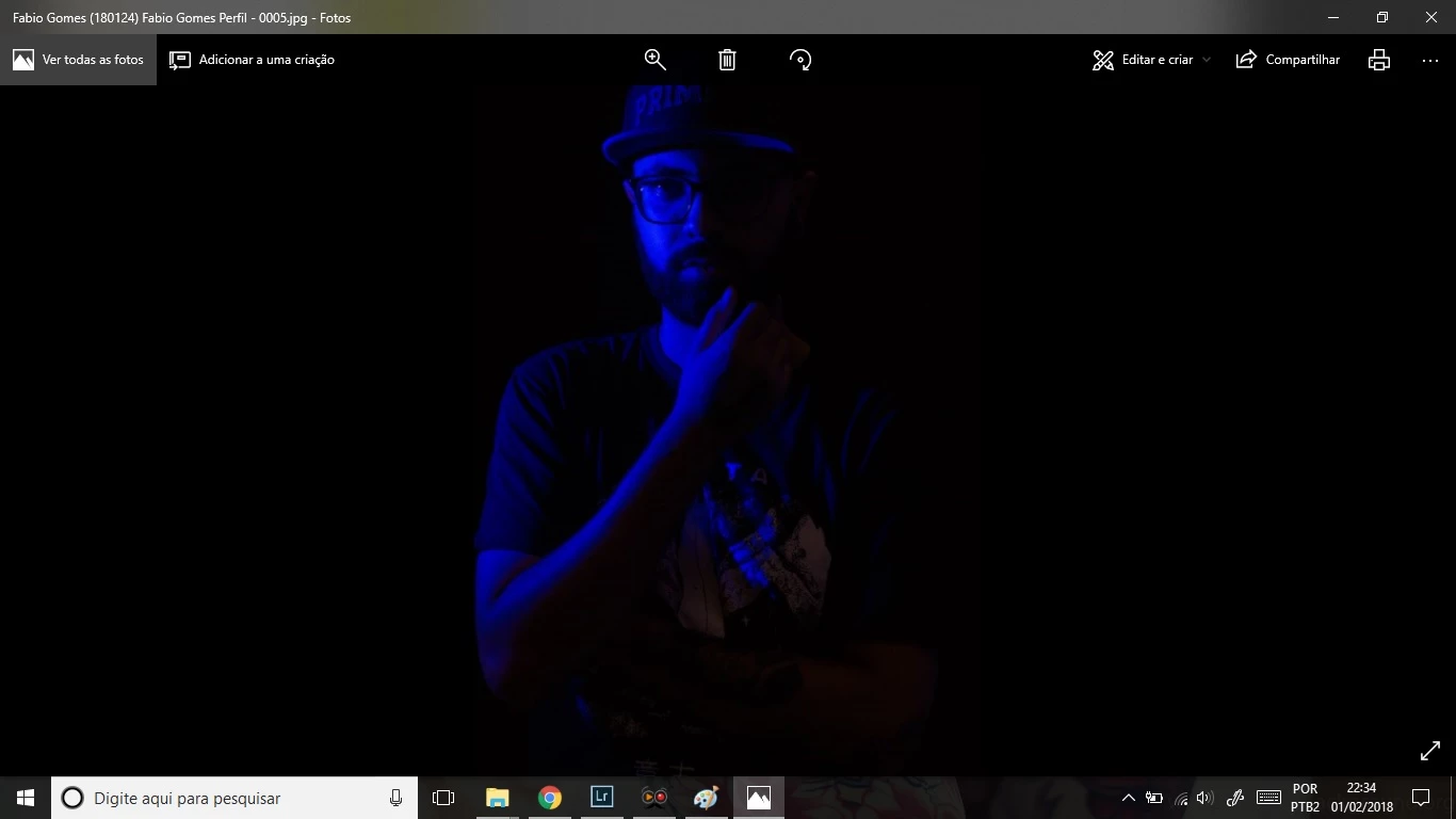

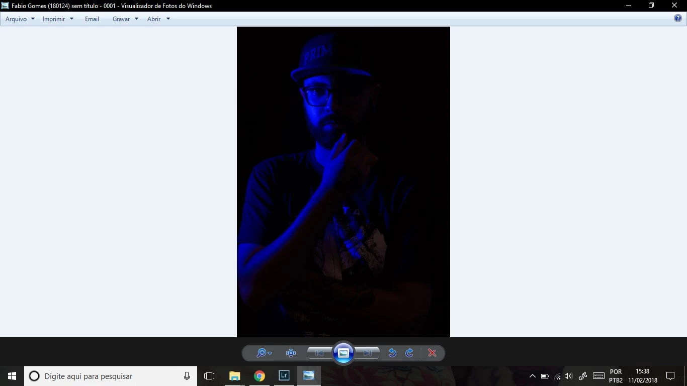

    February 11, 2018
    Look the difference between windows ten's photo viewer and windows seven's photo viewer. The major problem is when i upload the photo on sites, like Facebook or Google Drive, it's look extremely noise.
    Windows 10 photo viewer.
    Facebook.
    Somebody may help me?

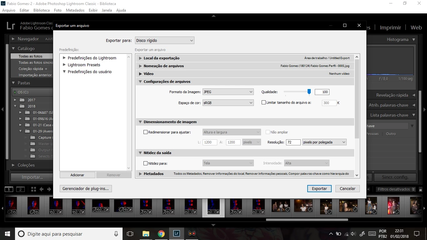

    February 11, 2018
    My Lightroom has the same problem. This's my output export settings.
