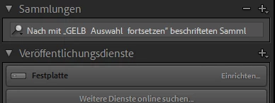

Filtering folders and collections by entering text in the field above the folder or collection hierarchy in the panel on the left no longer works. When I enter a text, the result always remains empty. I'm not sure how long this has been the case. It could coincide with the upgrade to version 13.
Filtering by color, synchronization or favorites does not work either.

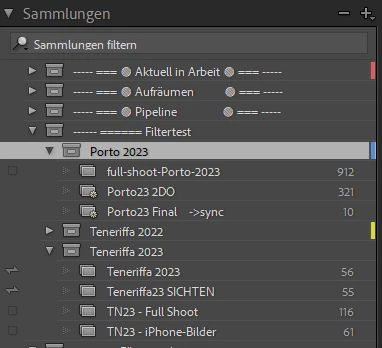

I have created a collection set to test this:
If I filter for "Teneriffa", "Porto", "2022", "2023" or for "collections marked yellow", I should get hits. However, the results list always remains empty. Here, for example, is the result when I filter for yellow collections:
Is there perhaps a setting somewhere that I have inadvertently changed?
I would be really grateful if someone could give me a tip.

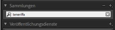

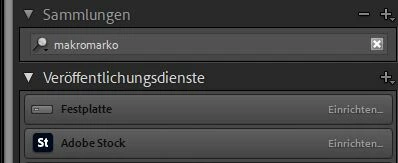

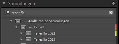

Because the error always occurs suddenly, I test from time to time to see whether it will disappear just as suddenly. Like a few minutes ago. I filtered the collections for “teneriffa” AND IT WORKED PERFECTLY WELL! Hooray... let's party!
Then I used a different term, unfortunately without success:
After that I tried “teneriffa” again and - guess what - it doesn't work anymore: 

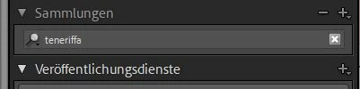

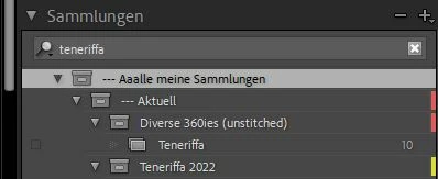

Here's how filtering ooks like in the exported catalog:
Here's how filtering looks like in the corrupted catalog:
