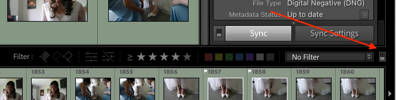

However, recently I've been using LR Classic on my MacBook Pro M1 Pro and noticed that the Filters do not stick. In fact, they don't even show by default at the bottom of the screen (right hand side). So every time I quit LR I have to go and choose 4 star+

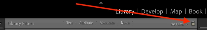

1. Do the menu command View > Show Filter Bar to show the main Filter bar at the top of the LR window (keyboard shortcut shown in the menu).
2. If the lock icon at the right end of the Filter bar is open, click it to close it:
Alternatively, make sure the menu item File > Library Filters > Lock Filters is checked.

Look at the far right side of the filter bar. There is a lock icon. Click on it so it gets closed.
-- Johan W. Elzenga

Sorry, there's no lock icon on my LR Classic - and I can't ever remember seeing one on the filter bar.
There is a toggle switch. Goes up and down. Up seems to engage the filter set. But when I quit, then reload, that switch goes down (Filters unset).
