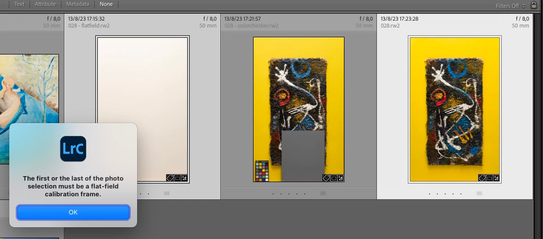

I want to use a flat field correction to correct for uneven lighting of a painting. So I have one photo of the painting, and another one of a whitecard in front of it, completely covering the painting.
Lightroom refuses to do this, complaining that one of the images must be a flat field image.
It seems to look at the uncropped raw image and require it to be entirely white, as a quick test covering the entire lens with a white cloth does allow for a flat field correction. But that is not what I want to do.
Is there any way this could at least be changed into a warning that I can override? Or even a function for it in the API would be great.
See attached screenshot for the error message, along with the two (cropped) photos that were selected when trying Library->Flat-Field Correction

I have since found out that the reason it doesn't work, is that Lightroom refuses to do it if the flatfield image is not completely "flat", i.e. in my case if there are edges around the whitecard showing.
That is impossible to prevent out of camera, and cropping the raw image doesn't solve this.
I have found a workaround, but it is quite cumbersome and I'm not sure if it will preserve the quality, curious if anyone has a better idea.
The workaround is to crop the raw files in Lightroom (i.e. crop the painting and apply settings to the flatfield image), export as tif, and then reimport those. Now the crop is baked in, and it does work.
