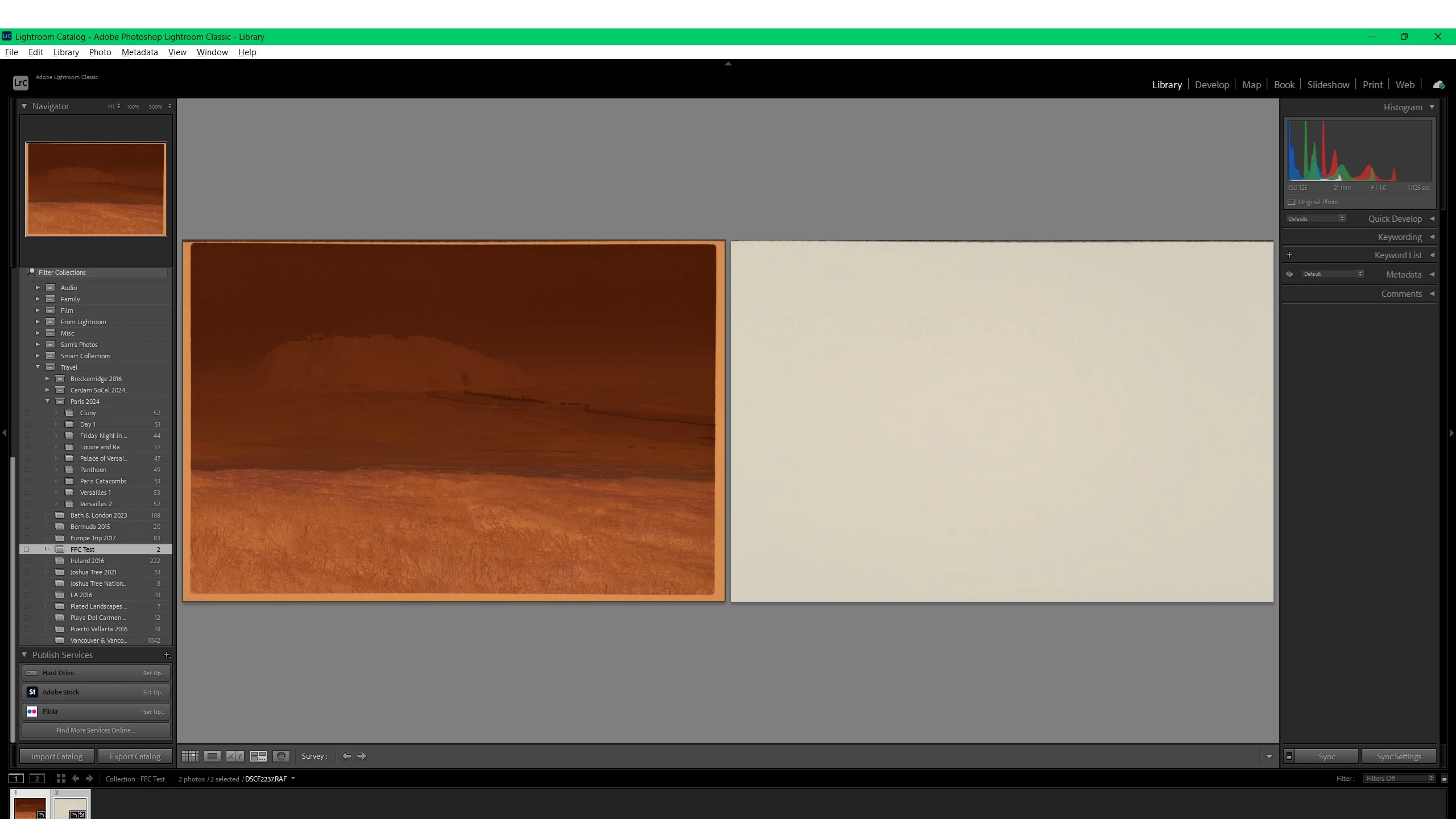

Oct 22, 2024 12:34 AM UTC
Hi Pavan - thanks for getting back to me.
Here is a screenshot of a photo to which flat field correction will not work.  The photo needing correction is on the left, and the calibration frame is on the right.  This is a photo of a 35mm film negative, and landscape.  When attempted, the photo remains .RAF, it does not apply correction and change to .dng.  My suspicion is that Lightroom does not recognize that this photo is not also a calibration frame, and as such does not apply.  Photos such as this with very little features (open sky, open ocean) will not work with flat field correction.  I have come across others reporting the same issue with these types of photos.
I've attached a screen recording as well showing the file is left unchanged after applying flat field correction.  I was able to apply flat field correction to other photos from this roll of film, but this photo and those similar to it would not apply.
Also, can flat field correction only be applied to one photo at a time?  Doing multiple photos did work for me in the past, but now it does not as Lightroom chooses the wrong photo to use for calibration and instead creates ghost images as it uses non calibration frames to apply correction.
The ideal fix would be for the user, not Lightroom, to specify which is the calibration frame and tell Lightroom to apply it to all the selected photos, rather than Lightroom attempting to decide which is the calibration frame, which seems to be the root of the issue in my experience.
Thanks again for your assistance, very much appreciated!
