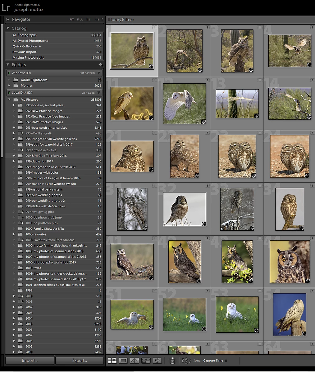

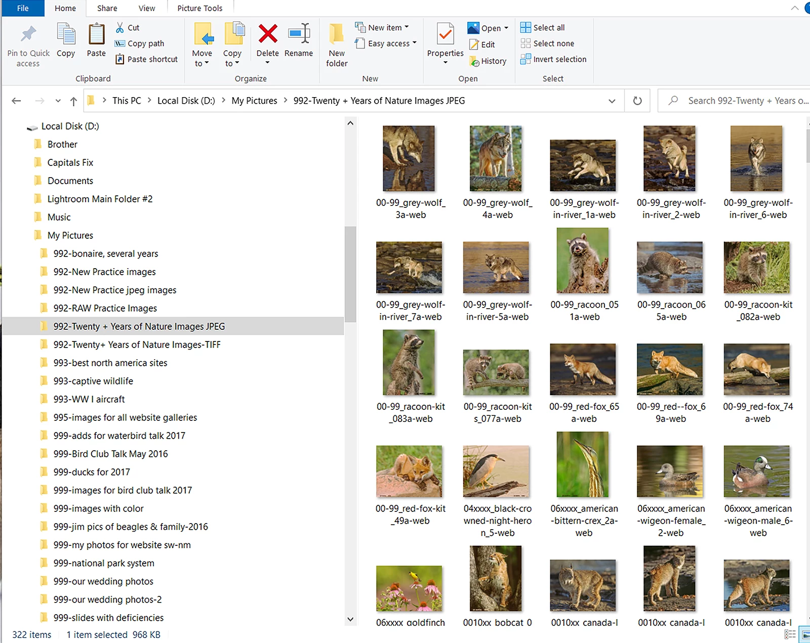

Sorry, this is a simple error but I cannot seem to correct it. I created a folder called Twenty + Images of Nature Images TIFF and filled it with large size TIFF photos. I then created a similar folder Twenty + Years of Nature Images JPEG and filled it with identical JPEGs. I cannot recall whether I created them in LR or outside; thought it was the former but perhaps not. I subsequently ran through and keyworded all of the imahes in both folders.  I thought all was done but I cannot find those two folders in LR6 (Classic, not Cloud).I understand that I should have created the folders in LR but probably did not. How do I get these folders into LR? I am pretty sure Import is the wrong move and I suspect Synchronize is the right move but I cannot figure out how to proceed. Any help will be most appreciated as I put a lot of time and effort into the project.

Do you have the folder that those folders are in in LR6? It looks like (from your screenshot), that you have them in a folder called "My Photos."
