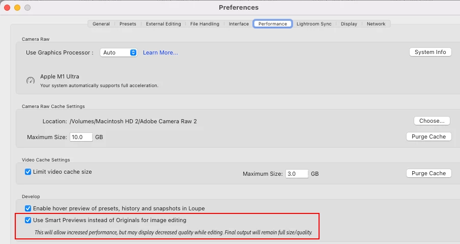

Did you also enable the preference 'Use Smart Previews instead of Originals for image editing'?

Yes, it is enabled.
