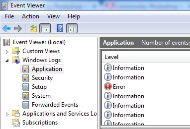

    Please follow the steps to get the error log from Event Viewer.
    > Open Event Viewer by clicking the Start button, clicking Control Panel, clicking System and Security, clicking Administrative Tools, and then double-clicking Event Viewer.  Administrator permission required If you're prompted for an administrator password or confirmation, type the password or provide confirmation.
    > Expand Windows Logs in the left hand side panel.
    > Click on Application.
    > In the middle panel, you will find error
    > Click on the error log.
    > Post the error Information which you find in the General Tab.
