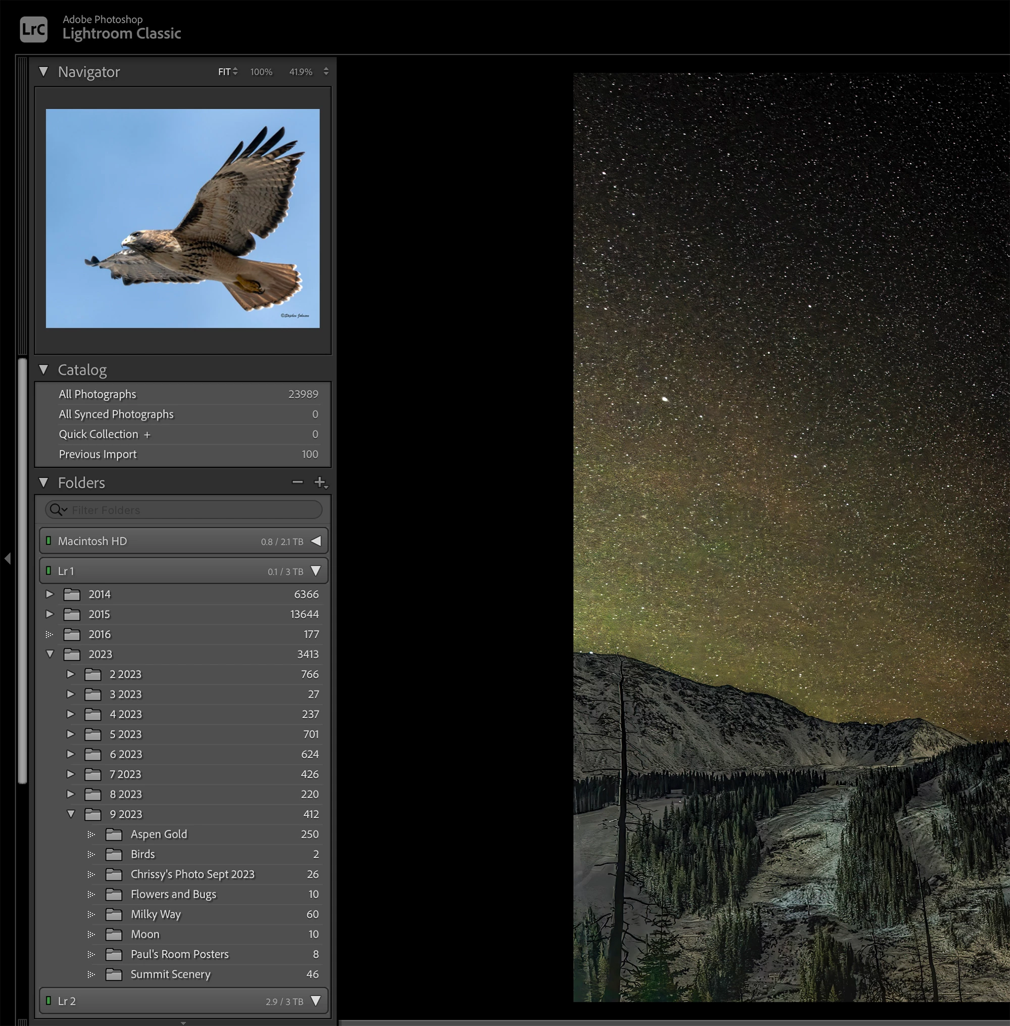

I was running out of space on my external hard drive that was connected to Lightroom Classic. I decided to attach a 2nd external drive to my iMac. In so doing, I had a few problems so a took the original external drive off LRC. Then I tried adding it back along with a 2nd external drive. Can't seem to get them on my LRC Left Side Menu.
My original external drive is LR 1. The second drive is LR 2
My scheme for my photos shows the year, month and then different titles for what ever I have shot.
Starting in 2014 .. 2014 09 .. Summit Scenes, Milky Way etc.
I've attached photos. I know how to remove folders from LRC but when I try to add my drives back to LRC, I am not getting everything as it was before.
Hope the photos help.

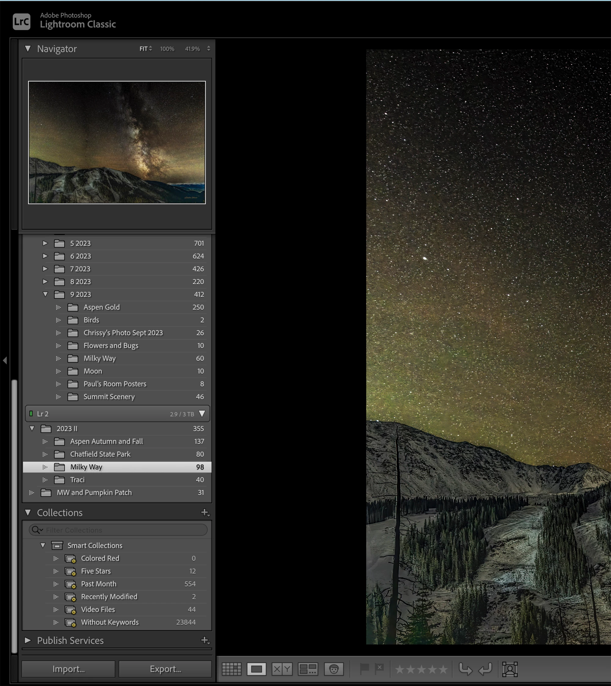

stevej46Author
October 28, 2023
I was able to move year 2014 and 2015 over to Lr 1 Menu. Started on 2016 and after I loaded 177 images, I got a error msg.. External Drive is full. The external drive was full before I started all this. So not sure how it could be full now on the LRC menu. I want every year from 2014 to 2023 to show on Lr 1 LRC menu. How do I do this>
I've got to arrange things differently on the Lr 2 menu page. So I should have under 2023 II the month 9 2033 and 10 2023.. And then I would place the actual photo names under the right month..

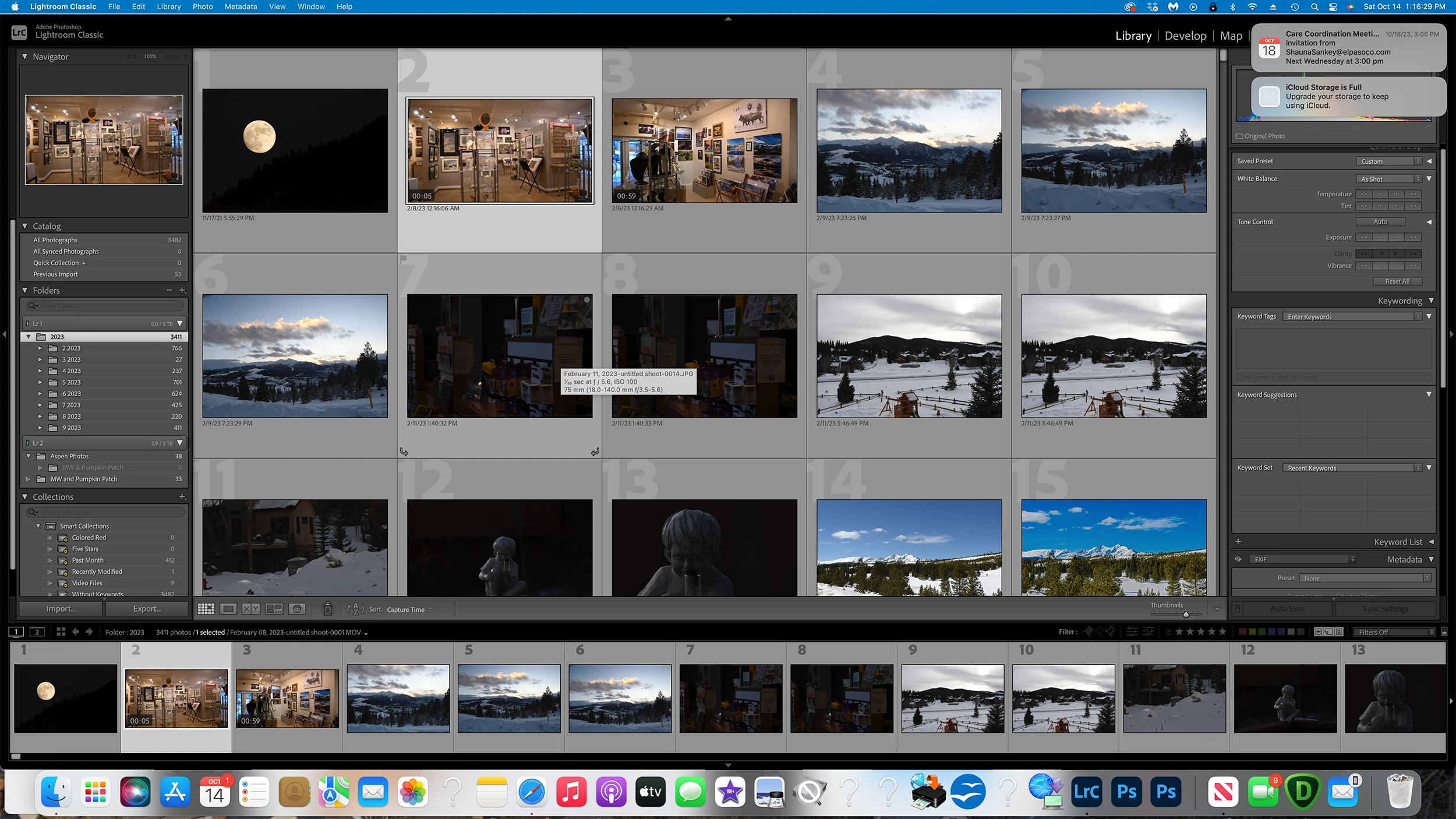

stevej46Author
October 14, 2023
Here are photos inserted.

JohanElzenga
October 14, 2023
Please describe in more detail what you did. You say "I know how to remove folders from LRC" but you do not seem to realise that this will remove the photos from the catalog and also all their edits. You cannot simply add these folders back to the catalog and expect the edits to be back! Do you have a catalog backup from just before you did all this?

GoldingD
October 14, 2023
I do not understand. You say you had Lr1, you added Lr2, then you disconnected Lr1, later reconnected Lr1, and after that Lr1 does not show in LrC.  BUT your screenshots show Lr1 and Lr2 in the Folders Panel. So, they or it are/is not missing.
Ahh, rethought, reread. Folder structure, and photo locations, and actual photos existing in catalog, in either drive, does not look like as before. I assume you moved various photos, perhaps entire folders from Lr1 to Lr2. How? Within LrC, or outside of LrC via Finder?

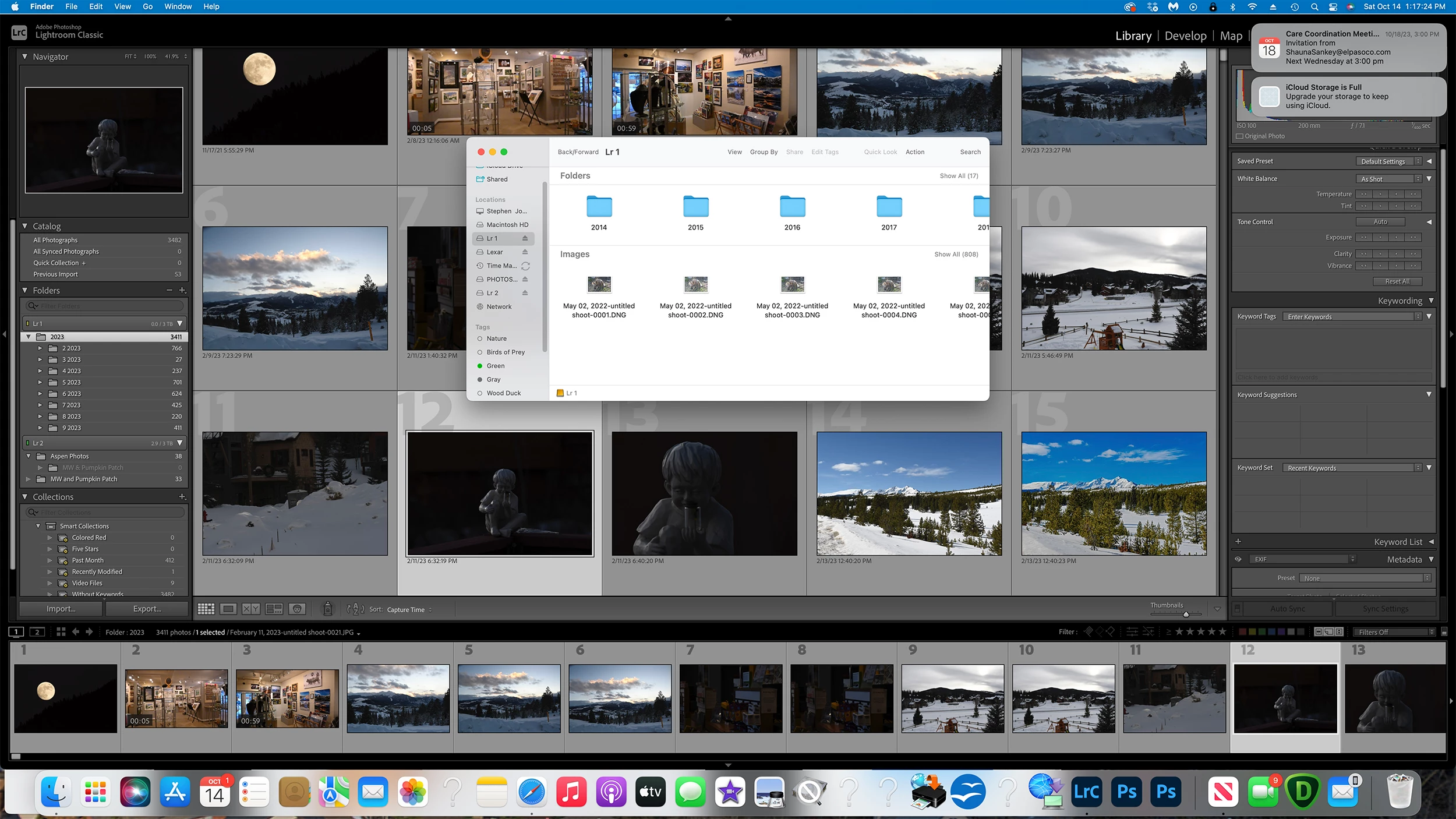

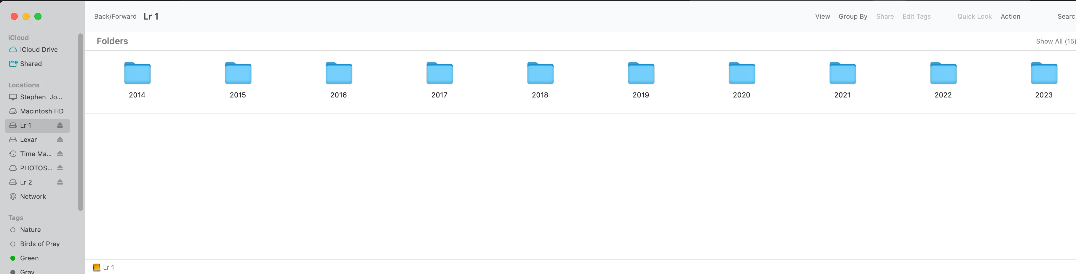

stevej46Author
October 14, 2023
Looks like LR1 and LR2 are from finder. Along with other attachments. Looks like I should have left LR 1 alone and not remove it. Now the edits won't be seen. All the photos are still on the two external drives. Lost a heck of a lot of work. But anything I printed or posted were saved in other places. I have all my prints saved under Costco on my iMac.
