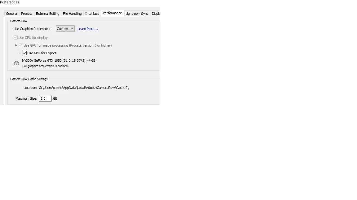

Lightroom Version Lightroom Classic version: 12.5 [ 202308091523-68a7abd6 ] Operating System: Windows 10
I have a GEForce GTX 1650 installed and Lightroom recognizes it (see attached). Updated to the latest driver. When I export photos, the GPU is not used. In task manager, the GPU is running at 1-2% while exporting but the CPU is running at 80-100%.
Further info - I just went through a hard drive crash and installed a new hard drive (SSD - old one was HDD), reinstalled Windows and Lightroom. Before the crash, the GPU was utilized but not now.
Tried so far but no go:
Deleting config.txt file
Clean reinstall of latest driver and reboot
Any ideas how to solve? Thanks,

A couple of observations, first one is a test that may or may not help to determine the issue at hand.
Change the Use Graphics Processor to Auto instead of Custom, restart LrC and look at the preference setting again, any change in what is displayed ? Does LrC enable the use on export?

Golding - thanks.  I upped the cache to 50GB - thanks for the tip.  GPU still not used when I did that.  When I switch from custom to auto - it switches from "full acceleration" to limited.  That must have something to do with it but I'm not sure what.
