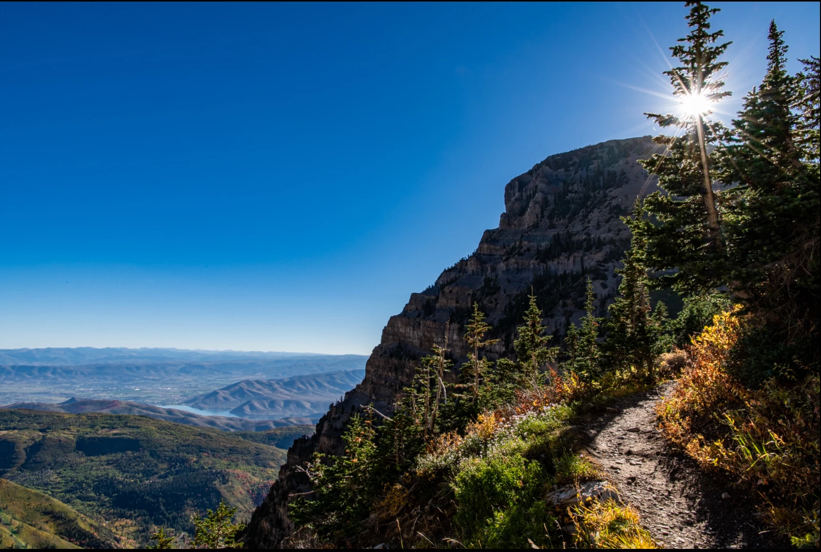

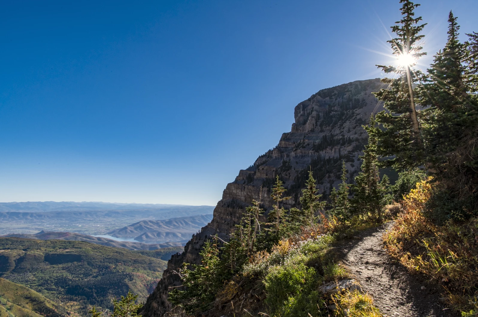

I have a i9-4900K, 4090 gpu computer and when i turn on the gpu in preferences, my images go darker than when it isn't engaged.  Attached are screenshots of what I am talking about.

hard to compare when posted as an attachment(s). Difficult to view side by side. So I have taken the liberty of posting them as shown below"
Looks like what, half a stop? And perhaps it is a contrast change due to the darker image, but does it look a bit more saturated as well?
As the difference is viewable on someone else's computer, I doubt if this is a monitor calibration issue.
