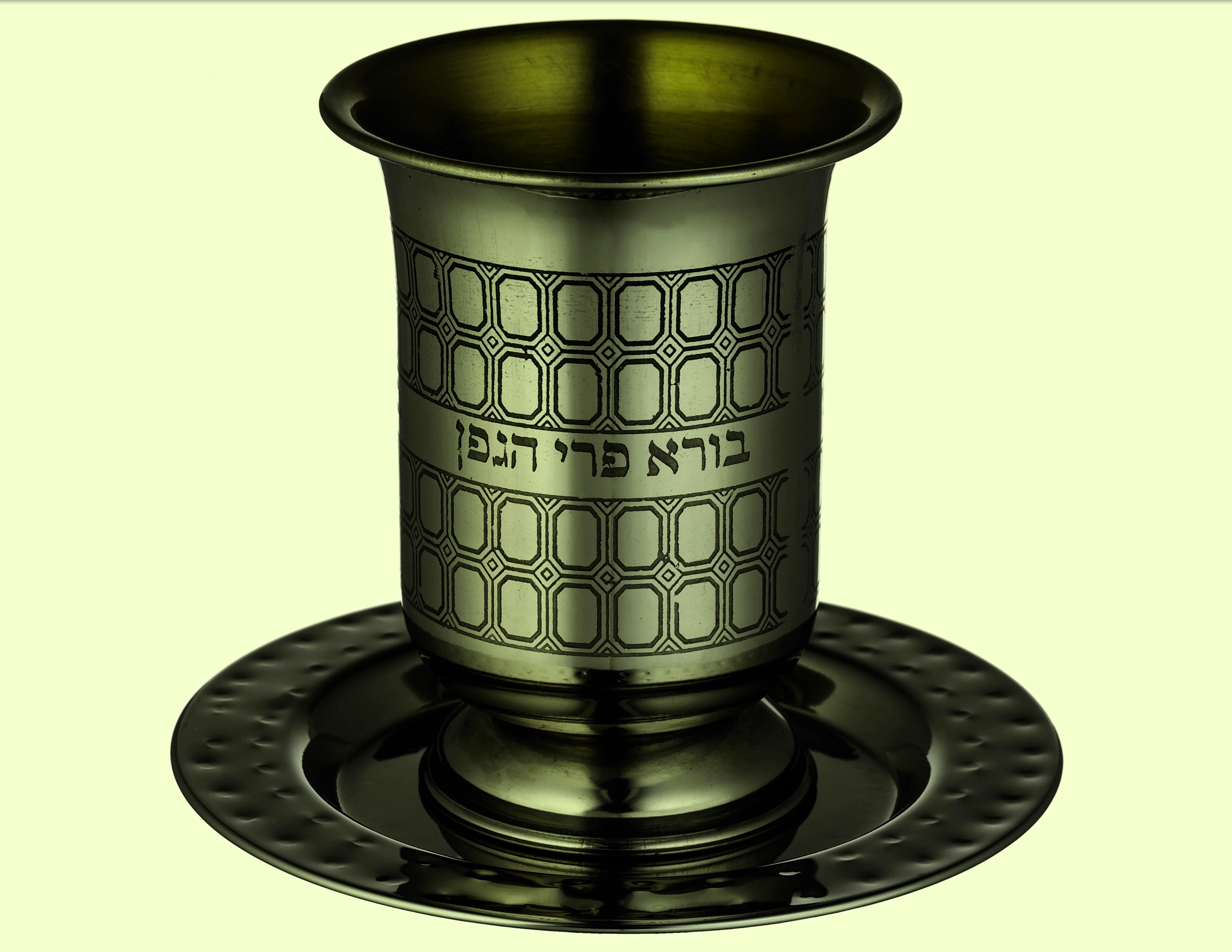

After updating LR Classic to v14.0.1 all pictures are green in Develop module.
Library module works fine.
Disabling GPU acceleration solves the problem, but slows down the work considerably.
MacOs Sequoia 15.1 on Mac Pro 2019 (Intel CPU)  with AMD Radeon RX 6800 GPU.
Never had this problem before.
Could be bug in Metal support?
Hope this will be solved in next update...
Sample attached below.
