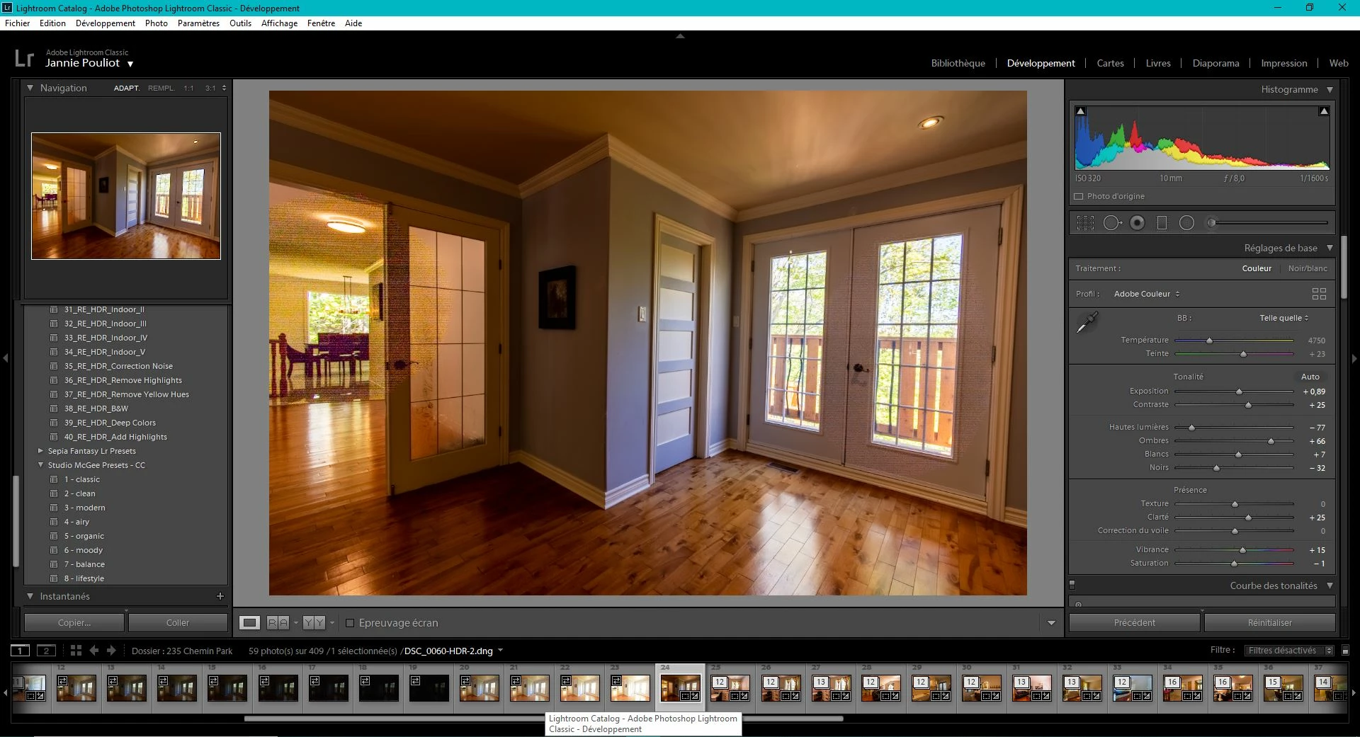

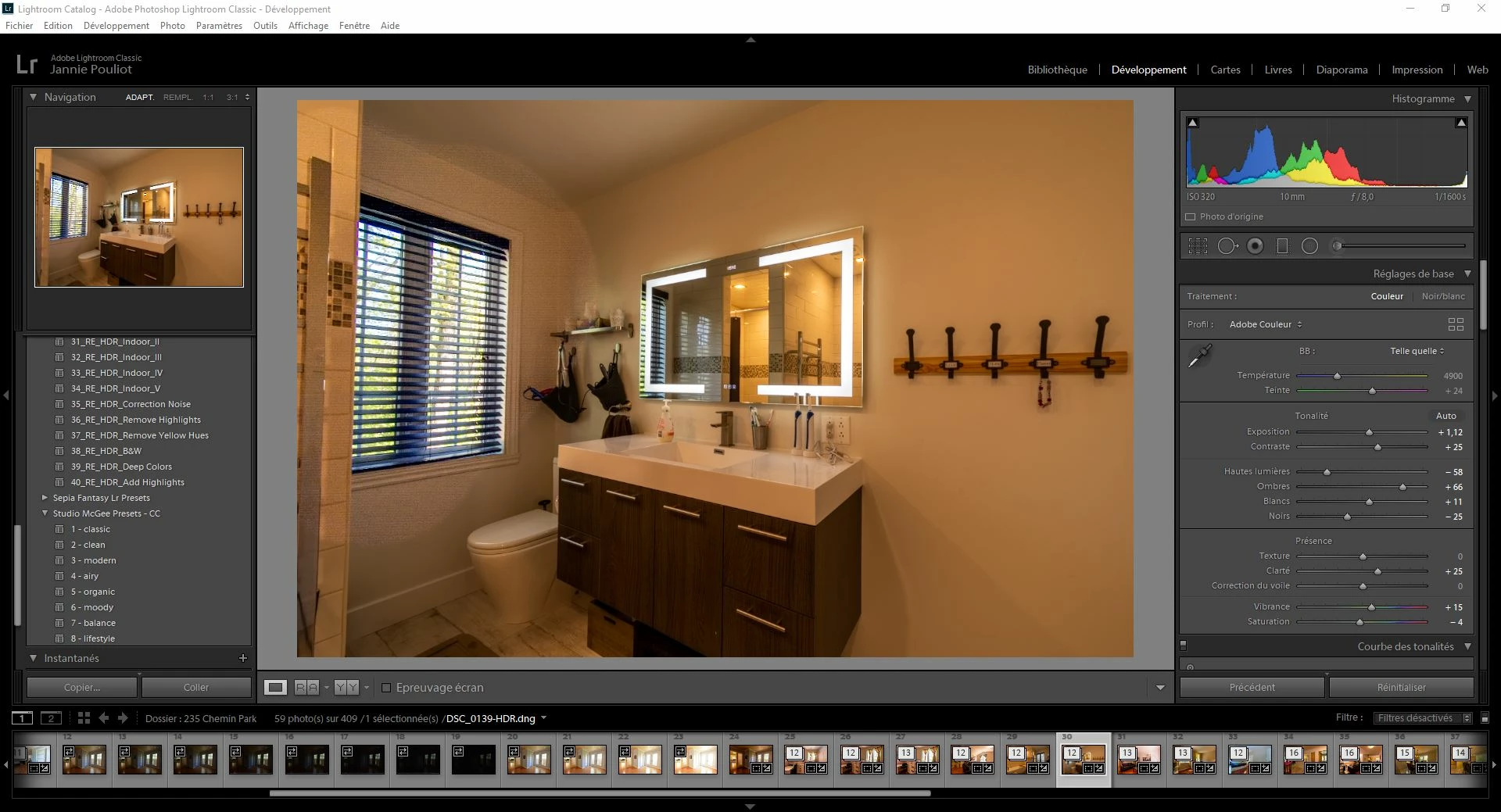

I am starting out in real estate photography and keep on having an issue when processing my images in LR as HDRs. I usually take 7+ images to create the HDR and the original raw files never seem to have the halo or "printer that runs out of ink" effect that I get after processing them. See screen capture for example.
HDR conversion of 12 images
Not sure if I'm doing something wrong when taking the image or when merging the HDR. Any help would be greatly appreciated. And it doesn't happen on every pictures so I'm really confused and a little bit desperate.

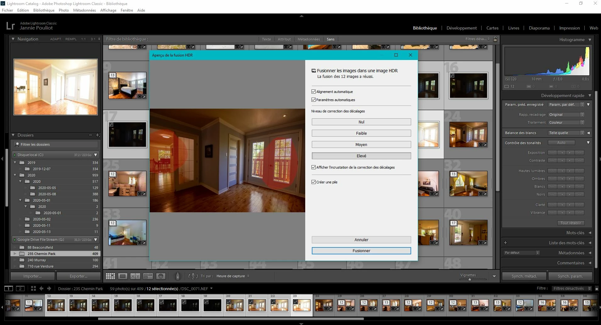

This looks like Deghosting artifacts. If something moves or enters the frame during shooting the HDR bracketed images Deghost tries to remove it and often chooses an inappropriate image file. In this case it is choosing one of the underexposed images that has high noise. Select 'Show Deghost Overlay' and it probably will highlight the areas with what you call the "halo" effect. Try setting Deghost to Low or None.
Second suggestion is to use no more than five bracketed shots even if shooting more (i.e. 7+). This will help to reduce the Deghost issue due to reducing the total time between shots.

If you are taking photos indoors with no cat or dog or anything moving in the photo, try processing the photos with deghosting turned off. That is what's causing the problem. If there ever are moving images, use the lowest setting to avoid the problems you are having.
