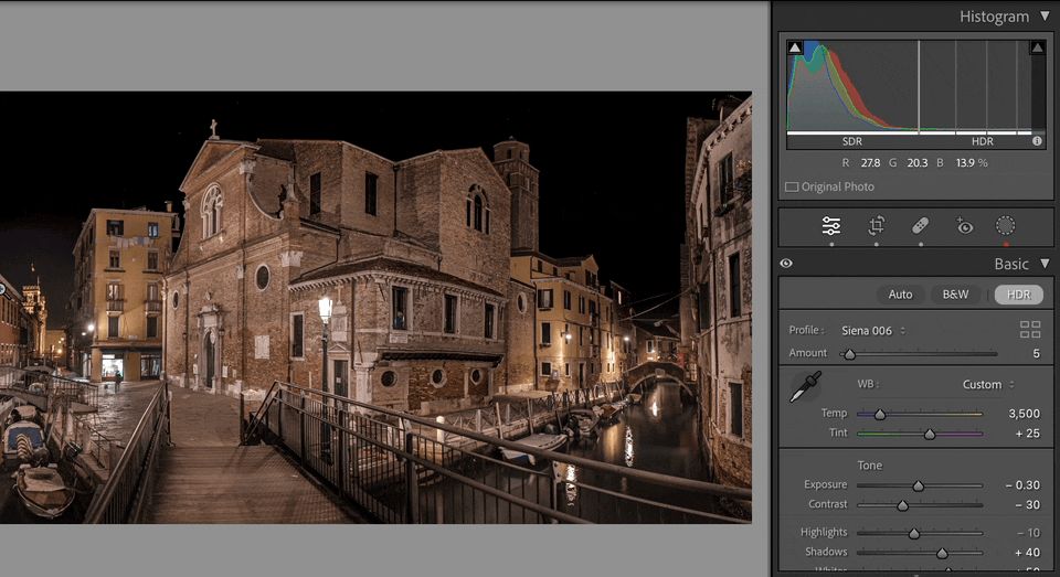

I’m using a 14" MacBook Pro; the 14" and 16" displays are HDR-capable to 1000 nits sustained, 1600 peak.
I took a screen shot of my HDR histogram, remembered I had taken another one earlier, then noticed they were different. The white line extended to different distances. Well, I had to be able to explain this before answering your question.
Then I remembered that the Adobe article “High Dynamic Range Explained” (written by the chief engineer behind HDR) says:
quote
If you’re editing on a laptop or mobile device, and you have automatic/adaptive brightness enabled, be aware that moving into a brighter or darker environment will cause your display’s available headroom to change. You’ll see these changes reflected dynamically in the histogram and on-image overlays as the balance shifts between yellow and red.
OK, but…I shut off adaptive brightness, so now what? I decided to see what happens if I manually adjust brightness while watching the HDR histogram. Sure enough, changing HDR display brightness changes the available headroom marked by the white line in the histogram (see the demo below). That means it isn’t really about adaptive display brightness, it’s only about the brightness level itself.
Now we have the answer to your question: On my Mac, the white bar can extend from almost 2 stops beyond SDR at maximum HDR display brightness, to all 4 stops at roughly 45% HDR display brightness or below. I figured those out after recording the demo below, so the full range is not shown in the demo.
