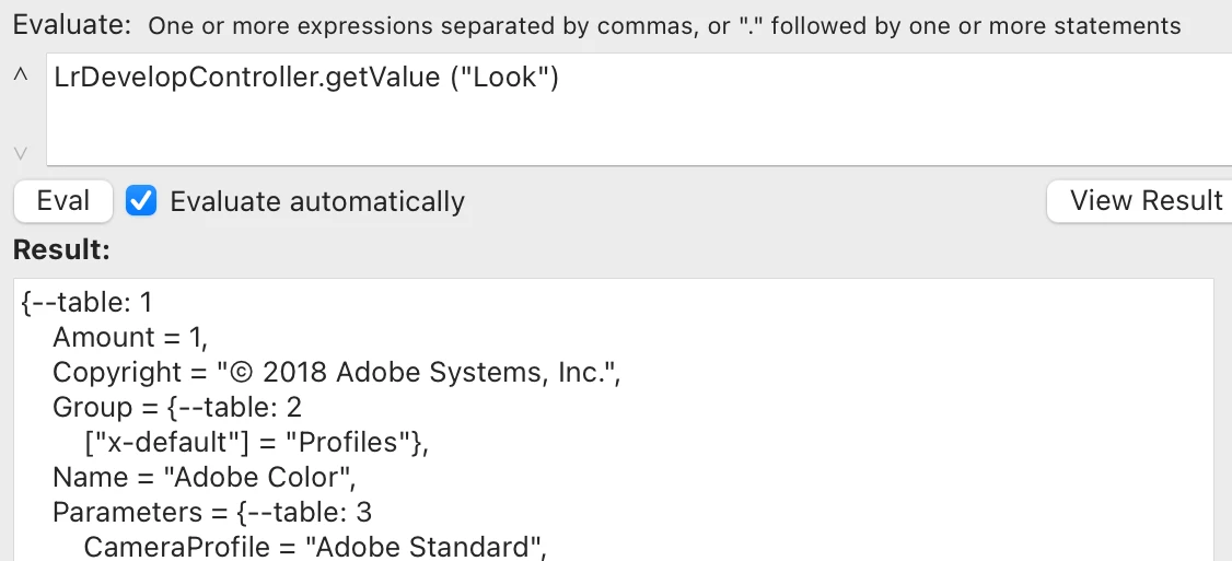

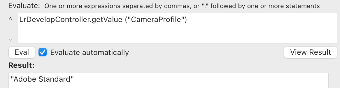

johnrellis
Oct 26, 2025 5:20 PM UTC
[This post contains formatting and embedded images that don't appear in email. View the post in your Web browser.]
"The Profile cannot be read or set from the getValue() and setValue() functions, and there aren't any specialised functions for managing the Profile either. Is that an oversight or is there something hidden from us?"
It's undocumented, as much of the develop settings are.
If the profile is a DNG camera profile (stored in a .dcp file), it is represented with this key/value pair in photo:getDevelopSettings():
    CameraProfile = "Adobe Standard",
If the profile is an enhanced profile, stored in a .xmp file, it is represented with two keys:
    Look = {
        Amount = 1,
        Copyright = "© 2018 Adobe Systems, Inc.",
        Group = {
            ["x-default"] = "Profiles"},
        Name = "Adobe Color",
        Parameters = {
All or nearly all such keys can be provided to LrDevelopController.get/setValue(), e.g.
When the API first started exposing developing settings in LR 3, the reference for photo:getDevelopSettings() added this warning (still present):
Adobe has mostly kept the list of setting keys up-to-date but made no attempt to document their values -- you have to reverse-engineer those. Most are obvious but some, especially those with masking, remove, and the other AI commands, are more obscure.
