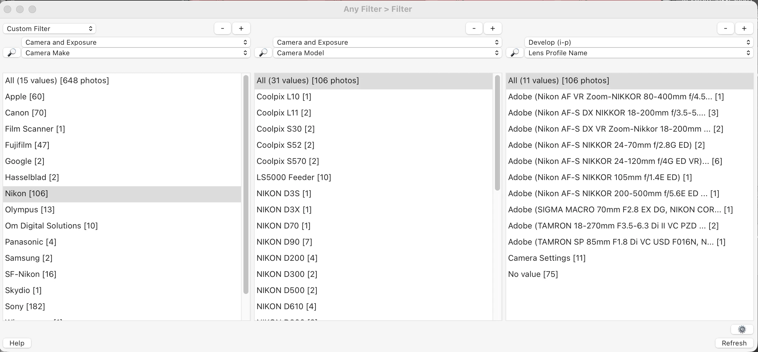

    Also, if you are regularly enabling lens profile corrections, you can use the Any Filter plugin to search the Lens Profile Name (what’s currently displayed in the Lens Corrections panel):

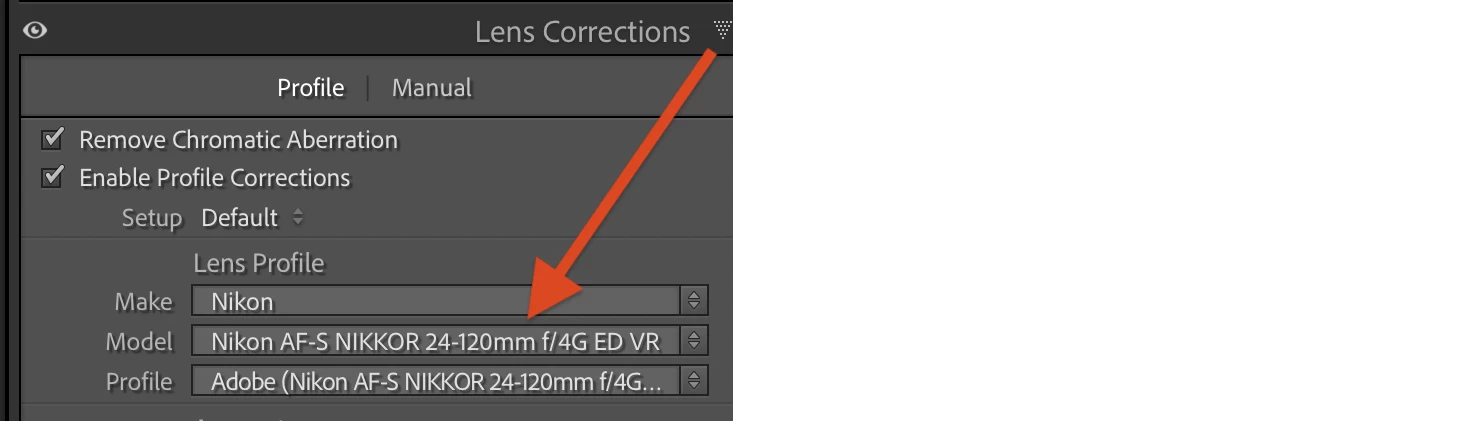

    What you see in the Lens Corrections panel is also inferred from the same MakerNotes fields:
    When you select Enable Profile Corrections, LR uses EXIF and MakerNotes fields to infer the lens and choose a lens profile. The Model shown in the panel is the lens model associated with the lens profile that LR chose.
    When things go well, the lens model chosen by LR is correct and it shows the correct profile. But based on reports here and the Camera Raw forum, things sometimes don’t go well. Due to ambiguous metadata in the raw file (or no metadata at all), LR can fail to automatically select the correct lens profile. And LR’s lens profiles may be less comprehensive than what Exiftool has in its database (I’m just guessing at that). And note that LR allows you to choose any lens profile for a photo, so what’s currently shown in Lens Correction may be wrong.

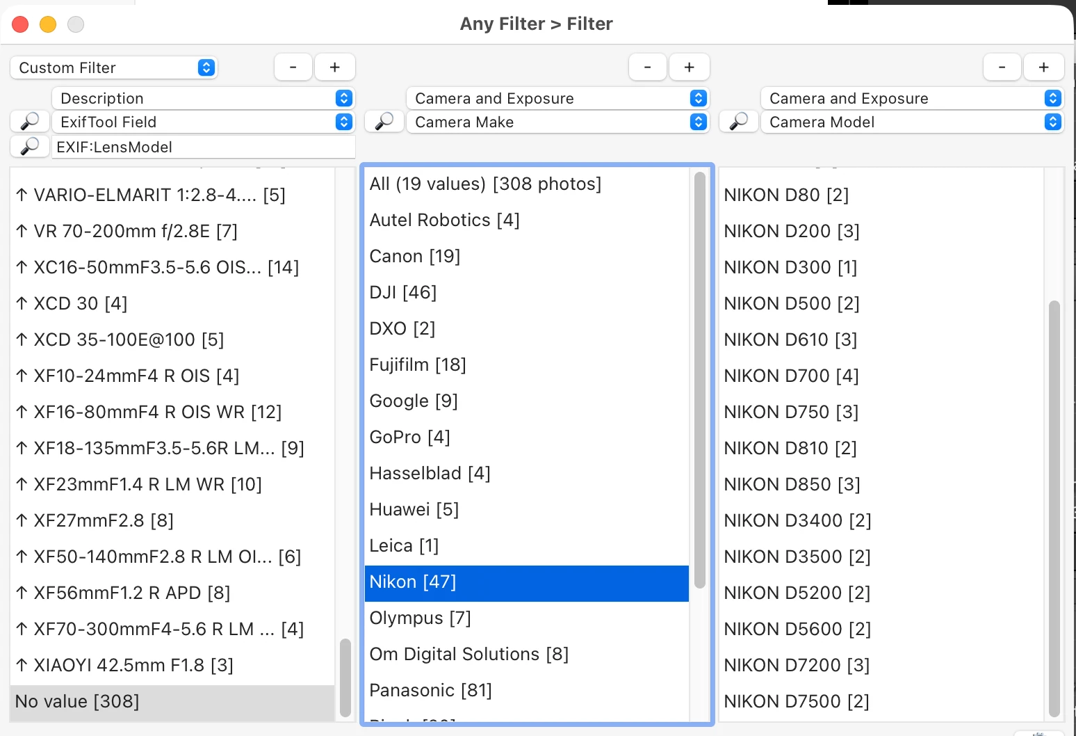

    In my catalog of sample raw photos, raws from the D5 (2016), the D850 (2017), D3500 (2018), D5600 (2017), and the D7500 (2017) are missing EXIF:LensModel:
    It looks like Nikon didn’t start consistently supporting EXIF:LensModel in its cameras until around 2018.

    The strange thing also is that, as the screen shots below show, in the library view, the lens is showing the generic name AND the develop view is identified with the correct name (this was not done manually, it showed as soon as I clicked the Enable Profile Corrections checkbox.  It is the Library view that is getting pulled on the metadata filter though.
