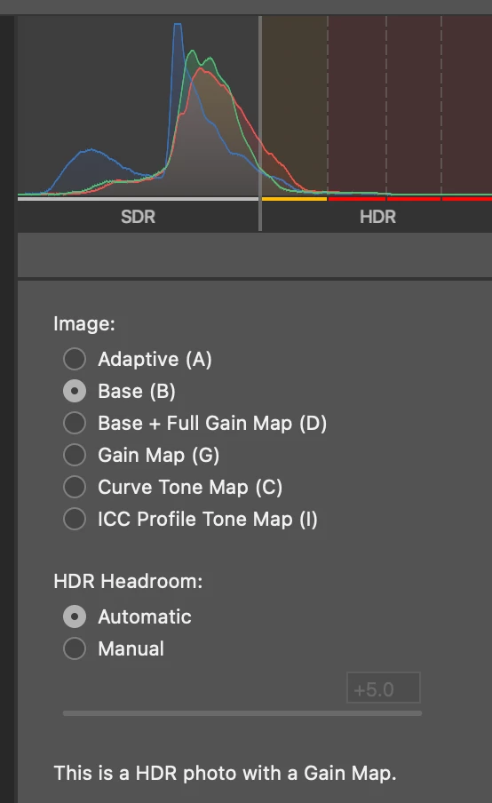

JXLs exported with "maximum compatibility" from LrC still appear to use HDR as a base rendition, however. I just exported a JXL, maximum compatibility, and opened in the gain map. It's analyzed as a 16-bit JPEG XL - HDR + Gain Map. (not SDR + Gain Map)

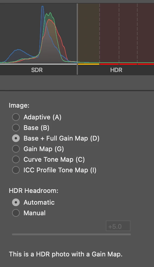

The Base rendition is actually an HDR image itself. Check out the histograms below—the first is "Base." I'd expect this to be SDR-only. Instead, it's HDR, and matches the histogram and appearance of the image in HDR in LrC.
The second is "Base + Full Gain Map"—which brings the histogram down into SDR territory, and matches the histogram and appearance of the image in "Preview for SDR Display" in LrC.
Because "Base" is HDR, if software doesn't support JXL gain maps, we have to rely on the software's own tone mapping of an HDR JXL.
This is all the opposite of what I'd expect.
With AVIF and JPG, the base is SDR and the gain map pushes the SDR into the HDR range. That's what I'd expect. So I don't understand what's going on with these JXLs.
