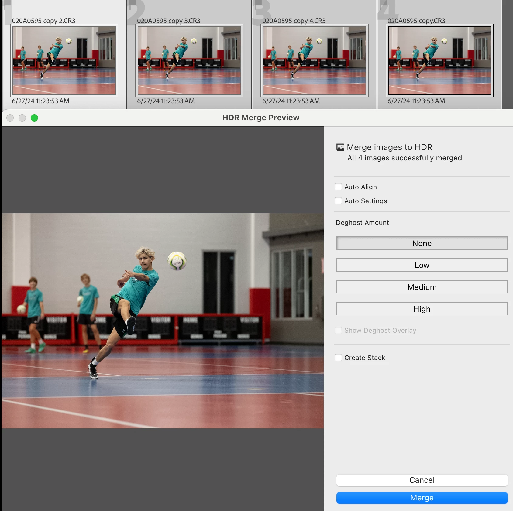

"In the Canon R5 camera the raw photo at maximum resolution is 40 Mbytes, which is too much for LR CC (latest version of 2024). I discovered this by switching to the minimum resolution (5 M bytes) and repeating what I did before! At this resolution the HDR was created! "
I don't think it's related to resolution -- Lightroom Classic (it's no longer called CC) should be able to handle those files. I just merged four raws from a Canon R5 Mark II (69 MB each):
If it's not merging your photos, that could well be a bug. Please upload the original raws to Dropbox, Google Drive, or similar and post the sharing link here, and we can take a look and possibly file a bug report.
