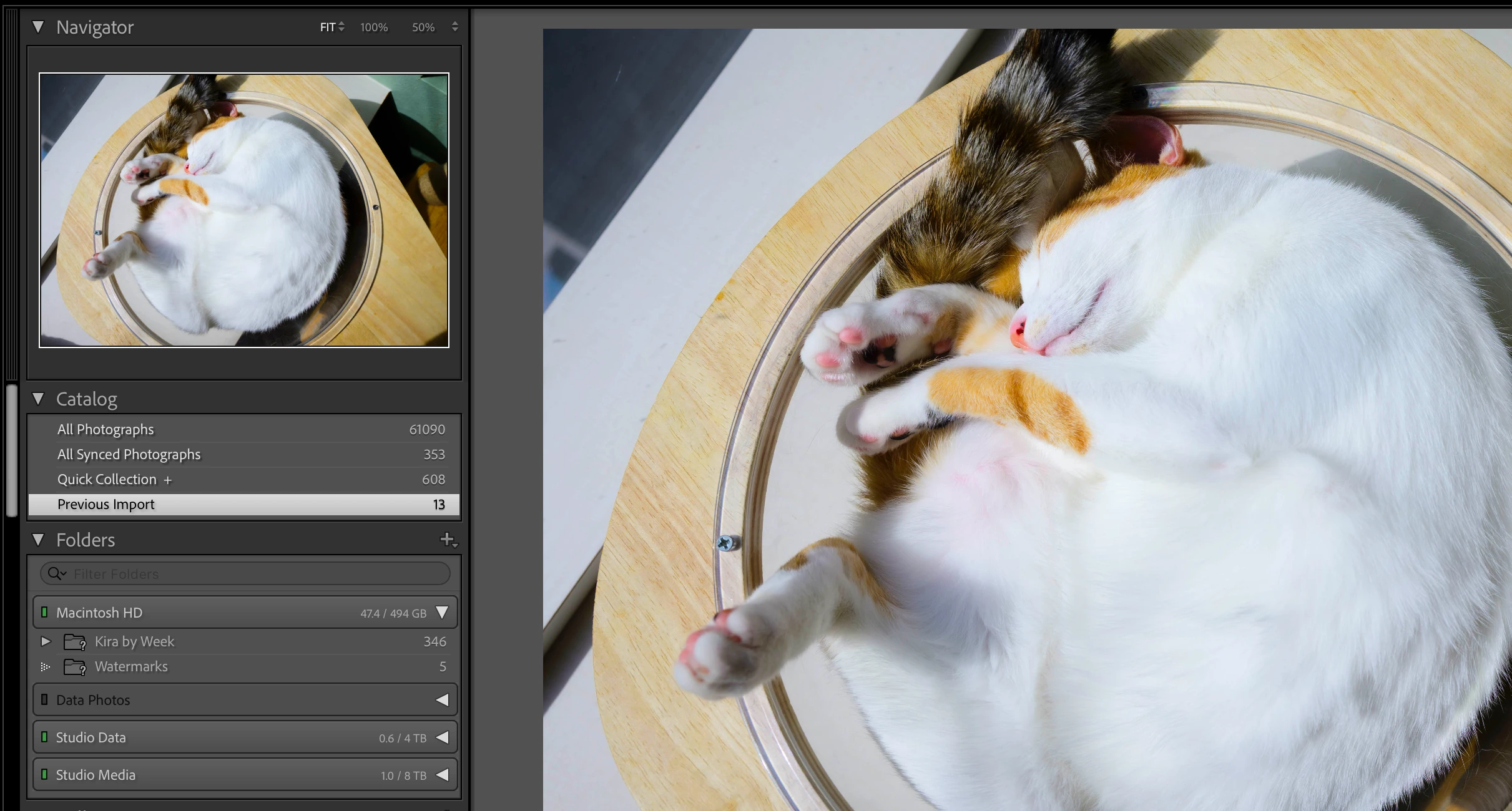

However, I did more digging and found this post where the user got an error about users/Pictures folder not being available. I don’t remember if I got that error, but I tried importing and I can’t (I also can’t access the LR preference panel anymore).  So I looked at my User/Pictures folder, which is an alias pointing to an external drive, since my Mac Studio system drive is so small.  The alias was broken (lost the link to the referenced folder) and once I repaired it, Lightroom started working normally!
Thank you all for the help. I find this bug really annoying, because it derives from a missing user/Pictures folder, which LR doesn’t even need. As you can see in the screenshot, Pictures isn’t referenced by my catalog either. This is a really dumb issue that I plan to submit with a bug report.
folder pane contents have been restored

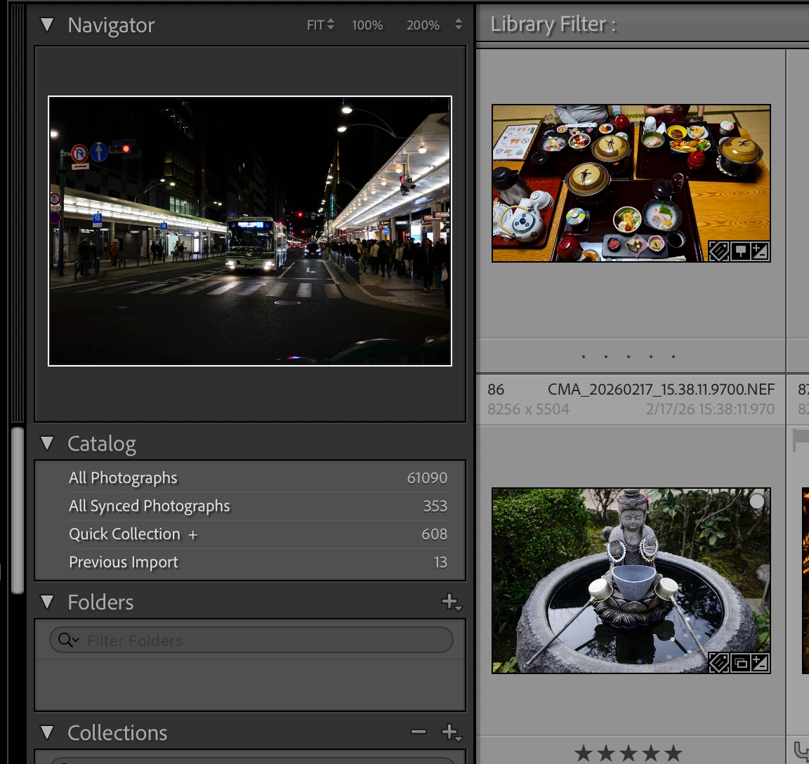

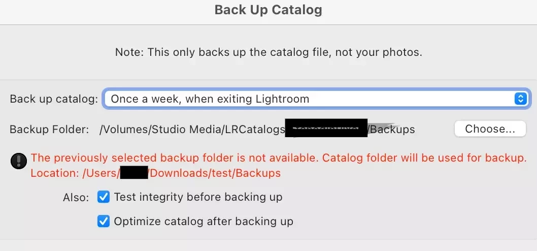

etchedinpixels
May 18, 2026 8:00 PM UTC
Thanks dj_paige for your reply. Sorry, this slipped my mind! This is what I’m seeing:
Showing how I started getting the message that the path was wrong, despite nothing changing. Note that this has since been resolved, but it was still weird that it started on the same day.
