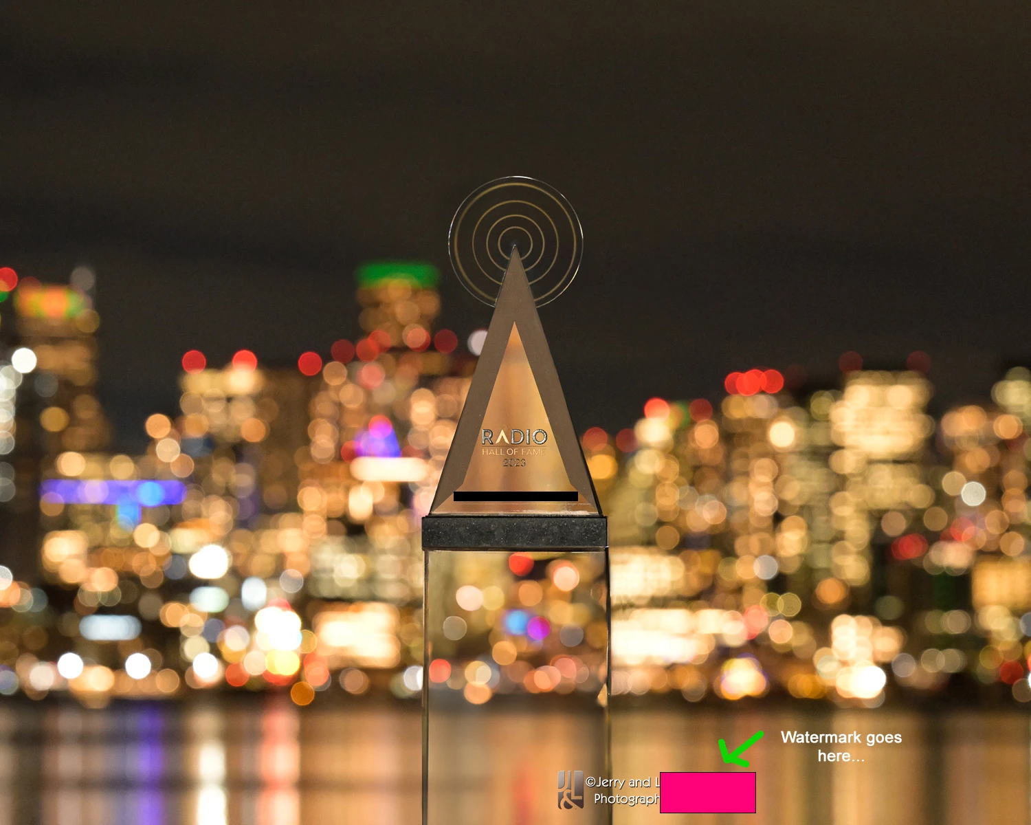

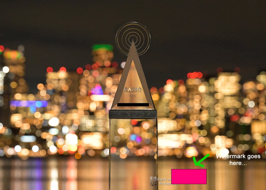

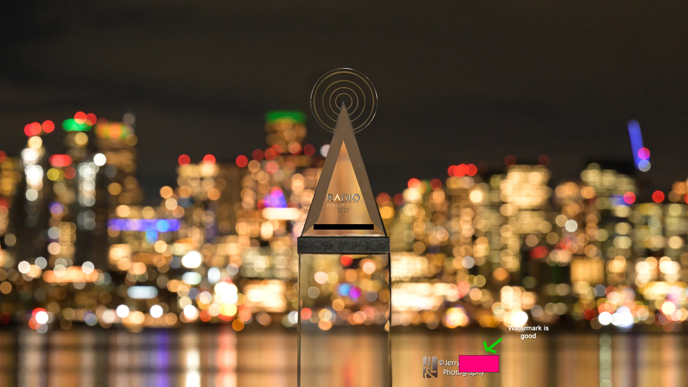

Some updates for everyone (thanks for your suggestions).
First - a clarification: I'm using a PNG that has our bug.
Following the above suggestions, I created a new PNG that was simply wider (same height), with the actual graphic on the left side, and blank transparency to the left.  I also max'd out the horizontal offset in LR to help push the resulting watermark as far from the right side of the image as possible.
My default placement for all our watermarks has alwasy been bottom right corner, or centered vertically, also on the bottom of the image.
Problems:
1. Since I'm keeping the PNG size option "proportional" enabled, this means the final look of the watermark shrinks significantly as I keep adding blank space to the PNG to push the watermark further away from the right edge.  This makes things impossible to manage as the absolute distance between the watermark and the right edge of the image varies significantly, because of the next point:
2. I need to produce 3 different crops for the set of images I'm trying to release.  8x10, 5x7, 16x9, since the client wants all 3 versions for various reasons.  Normally this would be a no brainer if the bug was always in the center or right corner.
But - the resized/expanded PNG that works for the 16x9 fails for the 5x7 as the watermark is now close to the image center.  Even worse for the 8x10.
I really don't want to have to create 3 separate watermarks, trying to figure out the right amount of blank space to get this to all work for the resulting versions is a real PITA.
The alternative is to manually watermark these in PS, but that's not overly attractive either.  I'm spoiled by LR.  Normally I just "export" and out pops the image+watermark perfectly, now or 3 years from now.  This problem prevents that nice bit of predictable "automation".
I stopped doing manual watermarks years ago, b/c LR was a goto predictable solution.  Until now.
Hoping someone who knows this stuff better than I seem to can help.  And... my client's clock is ticking.
Thanks, everyone.
PS:  Just added the three files (with the recipient's name redacted) so you can see what I'm talking about.
