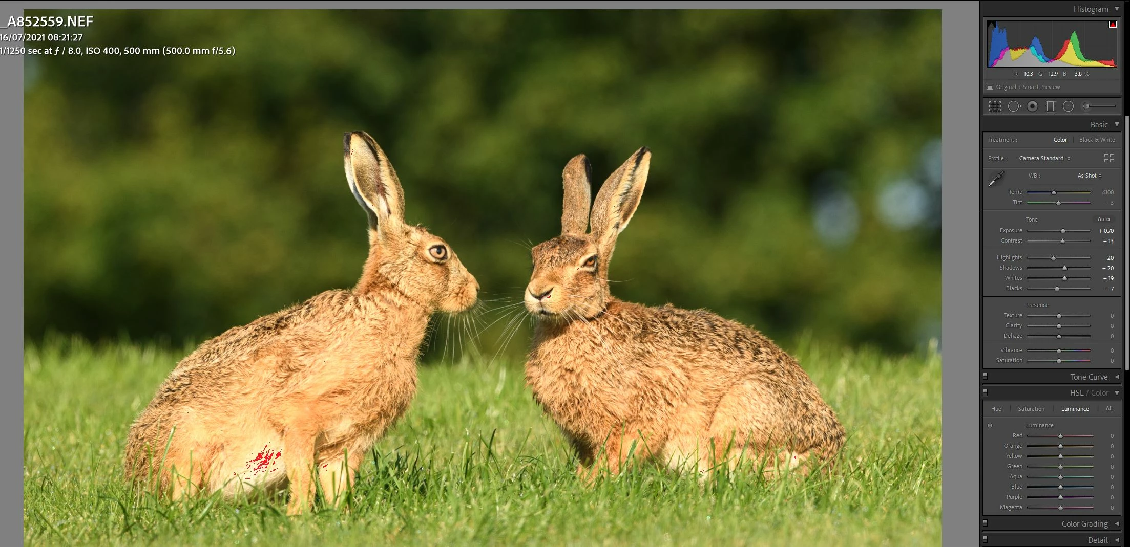

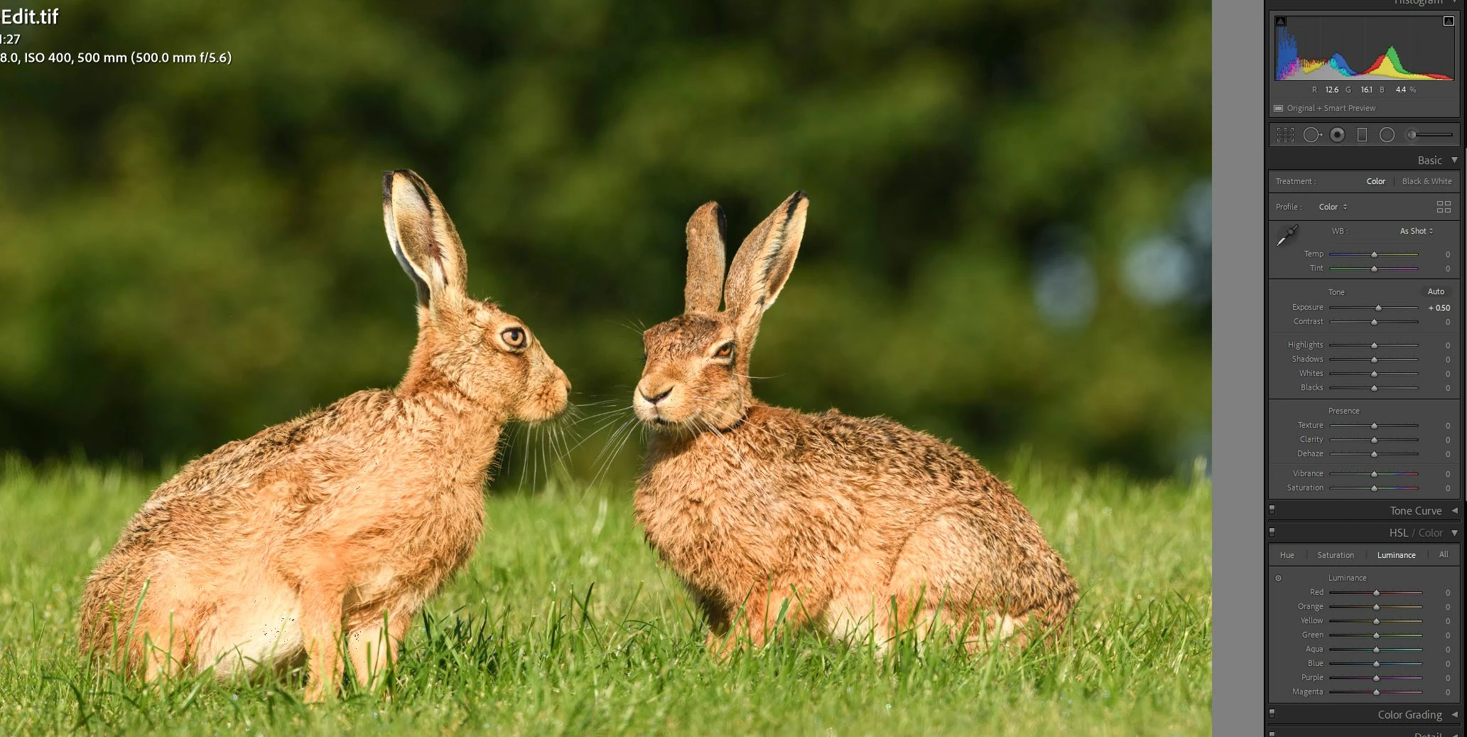

Today I noticed that a NEF converted to a TIFF behaved completely differently on the highlight clipping on the histogram in Develop.  Adding 0.5 to exposure in each  (NEF was +0.2 before conversion) showed different amounts of red highlight burning on the image (NEF more), but dramatically different on the histogram. I had to add almost 1.5 stops to the TIFF before the histrogram flashed overexposed.   The histograms look identical on first conversion, but you can see the red chaneel on the NEF is a lot more pronounced with the +0.5 and highlight warning is flashing.
Can someone explain this as not something I have seen or noticed before, but quite suprising.  Basically the highlight warning on the TIFF is way out
Thanks for any advice.
Mike

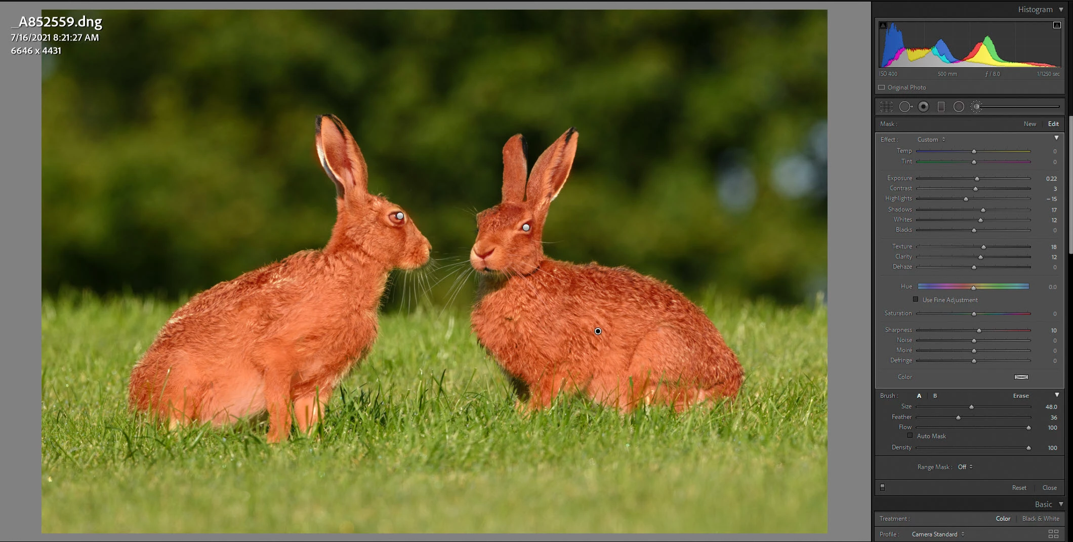

I checked your DNG file with your Camera Standard setting and with Adobe Standard and the clipping level differences were about the same. So we can rule out Camera Standard profile as the cause. Checking the DNG file further I see that you have a Local Adjustment Brush applied as below. Again this changes the settings adaption characteristics, which is causing the difference you are seeing between the NEF and TIFF White clipping level. With the Adjustment Brush removed the White clipping point for the DNG (i.e. NEF) file is Exposure +2.23 and for the TIFF +2.73. So much closer to the same. This is expected behavior and nothing to worry about. Enjoy!

The LrC Basic panel controls are image adaptive. The Highlights and Shadows controls when set to 0 apply a small amount of black and white clipping recovery. Because of this a TIFF file created with all controls set to 0 the image data will be different than the NEF file's raw data. In fact a raw file will often display Whites and Black clipping with all controls set to 0 that can be fully recovered using the Highlights and Shadows controls. A TIFF created from such a file (with 0 settings)will have that clipping permanently applied to its image data, which is NOT recoverable.
Also make sure you are exporting to ProPhoto RGB profile and 16 bit, which is what LrC uses internally.

Ah seems you are saying the distribution of pixels in the TIFF has already been truncated so less extreme values. Therefore requires a bigger movmeent in expsoure to hit the clipping warning.
So my TIFF images looks supper bright, but there is no highlight clipping so does that mean its bright, but not actually burnt out?

When you export a raw file to TIFF in LrC or use Edit in PS the resulting TIFF should look exactly like the raw file inside LrC with whatever settings you have applied.  If it doesn't then you have some other issue we need to investigate. Just make sure your Export settings and Edit In PS preferences are set to ProPhoto RGB and 16 bit.
