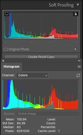

The demo below helps to show this. Lightroom Classic and Photoshop histograms shift consistently to follow the color space being used for previewing the image. If you set them consistently, the clipping points should be in consistent positions. Although I didn’t show Adobe Camera Raw, the difference is very obvious there: As you change the Color Space in Workflow Options among smaller and larger color spaces, in the preview window the on-image preview of clipping points shows more or fewer tones clipping. Which is absolutely and technically correct, because in a larger color space, you have more room before tones clip.
I’ll leave it to someone else to explain why the histograms don’t look exactly the same for the same preview color space. Like I’m not sure why the Photoshop histogram for the same image has that bump to the right in the red channel, that is missing in the Lightroom Classic image. For ProPhoto RGB that might be explained by the slightly different tone curve, but I would expect them to be more similar in Adobe RGB.
But that doesn’t change the main point: If you set the preview color space consistently in Lightroom Classic, Photoshop, and Camera Raw, the clipping points should be at about the same place in all three.

When I set up a soft proof for Adobe RGB (1998) with a rendered Adobe RGB (1998) document (to make Melissa RGB go away), and compare it with Photoshop, the two Histograms match pretty well except for the vertical drawing which is based upon the number of pixels being represented. I suspect (key word suspect, hate to assume and could be totally wrong here) that LR isn't building this Histogram based on the original pixel density of (in this case) a TIFF like Photoshop. It's building the Histogram based upon the preview converted from source to destination color space. But the bottom line is, close enough and the horizontal axis is that's key along with clipping:
