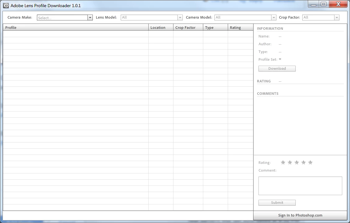

CS6 applications should not be launching when you try to open the Lens Profile Downloader. Please make sure you are downloading the correct installer for your OS:
Windows
Adobe - Adobe Lens Profile Downloader : For Windows : Adobe Lens Profile Downloader 1.0.1
Mac OS X
https://www.adobe.com/support/downloads/detail.jsp?ftpID=5491
It should look like the below screeshot:
