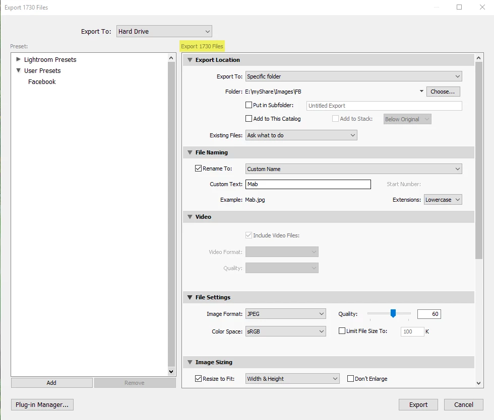

How do I export just only one image?
  • January 13, 2018
  • 12495 views
I'm done working on my image in the Develop. I right click and choose Export->Export... and then it shows 1730 files to exported. How do I just export one image or just the current one that I'm working in the develop? I'm using Lightroom Classic CC 7.1 Release.

    You currently don't have any photos selected, so LR helpfully assumed that you wanted to export all of them.  In Library view, select just the one photo and do File > Export.

    First, if I'm on the Develop tab, why do I have to select just one photo? Does LR automatically assumed that the current picture in the Develop tab is the image I want to export? Why do I have to switch to Library, select a single image that I was currently in the Develop tab and export?
    Second, even if I switch to the Library tab and select a single image to export, LR still shows 1730 files to be exported. Why is that?
    Third, it just start working now regardless which way I export (Library or Develop). For some reason, by select one and/or multiple images and deselecting again that seemed to cause LR to re-calculate or something and now it's getting the correct number of images to be exported now.
    Thanks for the response!

    January 14, 2018
