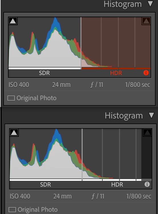

I should also have mentioned that not all images will use the full histogram. I've attached a screenshot showing the histogram for an image that only extends about 1 stop into the HDR range.
The top histogram shows the HDR range in red to indicate that the display in not in HDR mode or is not capable of displaying HDR. The lower histogram indicates that display HDR mode is ON and display is also displaying HDR data.

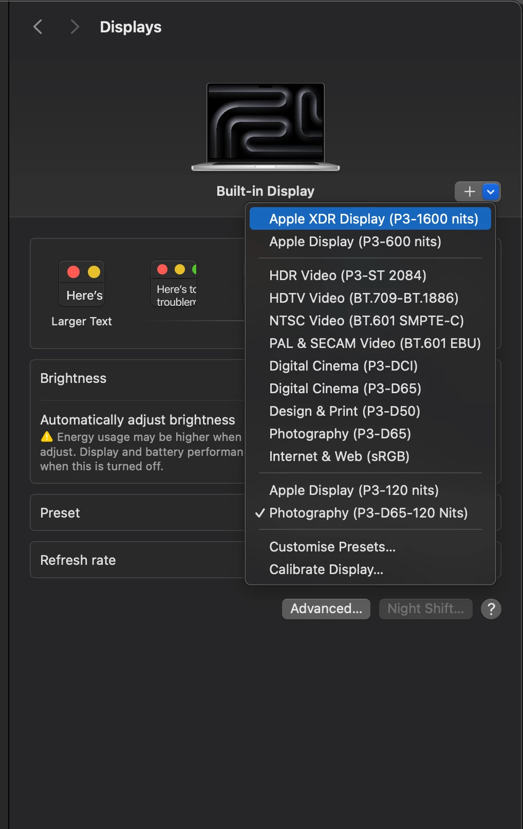

Dec 7, 2024 8:18 AM UTC
Make sure that you have enabled HDR mode in Displays section of macOS System Settings

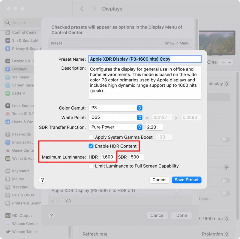

In the screen shot, Built-in Display is selected, so the Reference Mode preset applies to the Built-in Display, not to any external displays such as the external OLED being asked about.
In fact — and I need someone to correct me if I’m wrong about this — I believe the Reference Mode presets apply only to Apple displays that support them (so, not even all Apple displays), and never apply to any non-Apple displays.
Finally, just for completeness, what enables HDR on an Apple display that supports it (such as the XDR display in the 14"/16" MacBook Pro) is not the Reference Mode preset exactly, but more specifically, if that preset has HDR enabled in it. So, HDR on an Apple XDR display can also be enabled by your own custom Reference Mode preset if you created it with HDR enabled. But again…I do not think this info is relevant when discussing any non-Apple display.
