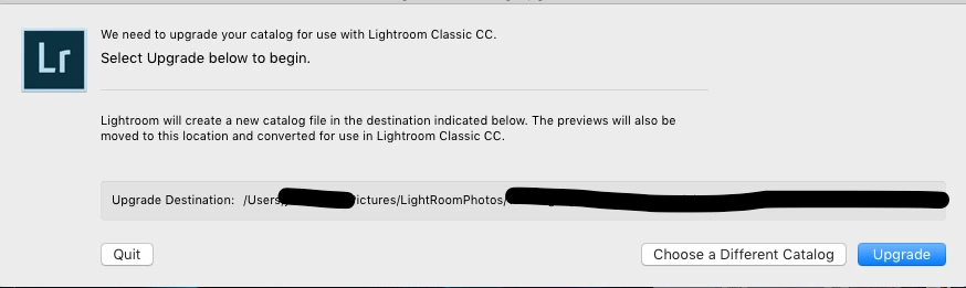

    joev66051531
    October 20, 2017
    What exactly does this screen do? What if I don't want to update. What if I want to try out this new version before updating this?
    Some one please tell me does this touch my RAWS? can I tryout the new version without updating.
    Some much cleared instructions here more precisely explaining what is about to happen when I hit UPGRADE would have been good for Adobe to have thought of.
    There should have been a better introduction of this version.
    Thank you.
    99jon
    October 20, 2017
    Your raw files are untouched. This is the same as upgrading in the past from Lr5 to LR6. A new catalog is created. Your existing catalog remains. Set the preference in the advanced tab to keep your existing version installed.
