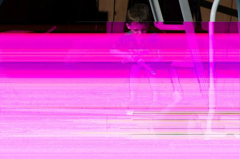

How non-destructive is Lightroom?  I am beginning to wonder.  I had a RAW photo I was editing.  Preview was fine, edit was fine, I went to export.  I ran into a little bit of lag exporting when I minimized Lightroom and started up the web browser.  I go and look at my exports, and everything exported fine except for 1 file (most likely when I was messing with the web browser).  The file appeared corrupted.  This is not the first time I ran into this problem.  I have had this happen multiple times.
So I delete the previews folder, I purge the cache, I import the RAW file again (btw, every other program sees this RAW file just fine EXCEPT for Lightroom), and still, every import it shows corrupted and exports the same as it shows.
To fix this, I had to go and delete the original RAW file, replace it with a backup, and re-import that backup.  So Lightroom... question.  Why are you destroying my RAW files?  You are suppose to be non-destructive... what is with this run-around?
So, TL;DR version would be this.  File was fine and not causing any problems.  It exported funky and everything I did after this "glitch" would not restore the file to appear how it should... not until I completely removed the RAW file (which everything else seen fine) and replaced it with the 'exact same file'.

I don't have all the answers. I told you that you wouldn't like or believe the answer, and I was right. You can look for other solutions, but I am almost certain there is a hardware problem somewhere. I don't know what it is or where it is. The problem you are seeing is "usually"  an indication of a hardware problem.
As JimHess said, this is caused by a hardware malfunction which corrupts the raw file, but somehow leaves the embedded JPG preview fine. If you saw and edited the file without this corruption and then later the corruption appeared, then the problem could be the hard disk malfunctioning or memory malfunctioning. You can believe anything you want, but you will be missing an opportunity to discover the problem if you don't examine your hardware to isolate the problem.
Also, as you try to puzzle this out, please keep in mind, and use this in your thought processes, that Lightroom never writes to your original  RAW images. That simply isn't a function that exists in LR.

No you didn't have to do this, if you had an uncorrupted backup, you could simply replace (overwrite) the corrupted photo with the uncorrupted backup.
Please while you are throwing around the word non-destructive, remember that hardware malfunction is something that is destructive, and you'd be wise to investigate this.

I know that you aren't going to appreciate the answer, and probably aren't going to believe it. I don't know what you mean by "every other program" that doesn't have a problem with the images. Many programs only read the embedded JPEG preview that is included with every raw image. What you are seeing is an indication that there is a problem with hardware somewhere in your system. It could be a problem with the card, or the hard drive, or the card reader or cable. But somewhere in the system there is something that is failing. Lightroom doesn't change anything in the raw image. If you use Lightroom to import the images from the camera using some method, all it does is transfer the image to the hard drive. Lightroom never makes any changes to the image. You need to investigate to find where the hardware problem with is in your system.

I do have this question.  When I first edited the file in Lightroom, the preview which I am seeing, is this the preview of the embedded preview or the actual file?  When I first edited this file, before this problem, it displayed fine.  All edits were fine.  Everything looked good.  After the export, the preview I began seeing was this corrupted one.  I could not edit it or continue seeing the file any longer.
So, from the start, if this was corrupted.  Why was I able to see it ok?  Was it just the preview I was seeing?  And even if so, why is it that after this problem, only then did I start seeing the file this way?  If I open the file up in Adobe Camera RAW or even view it with Irfanview, it displays just fine.  I am only seeing this corruption on Lightroom.
