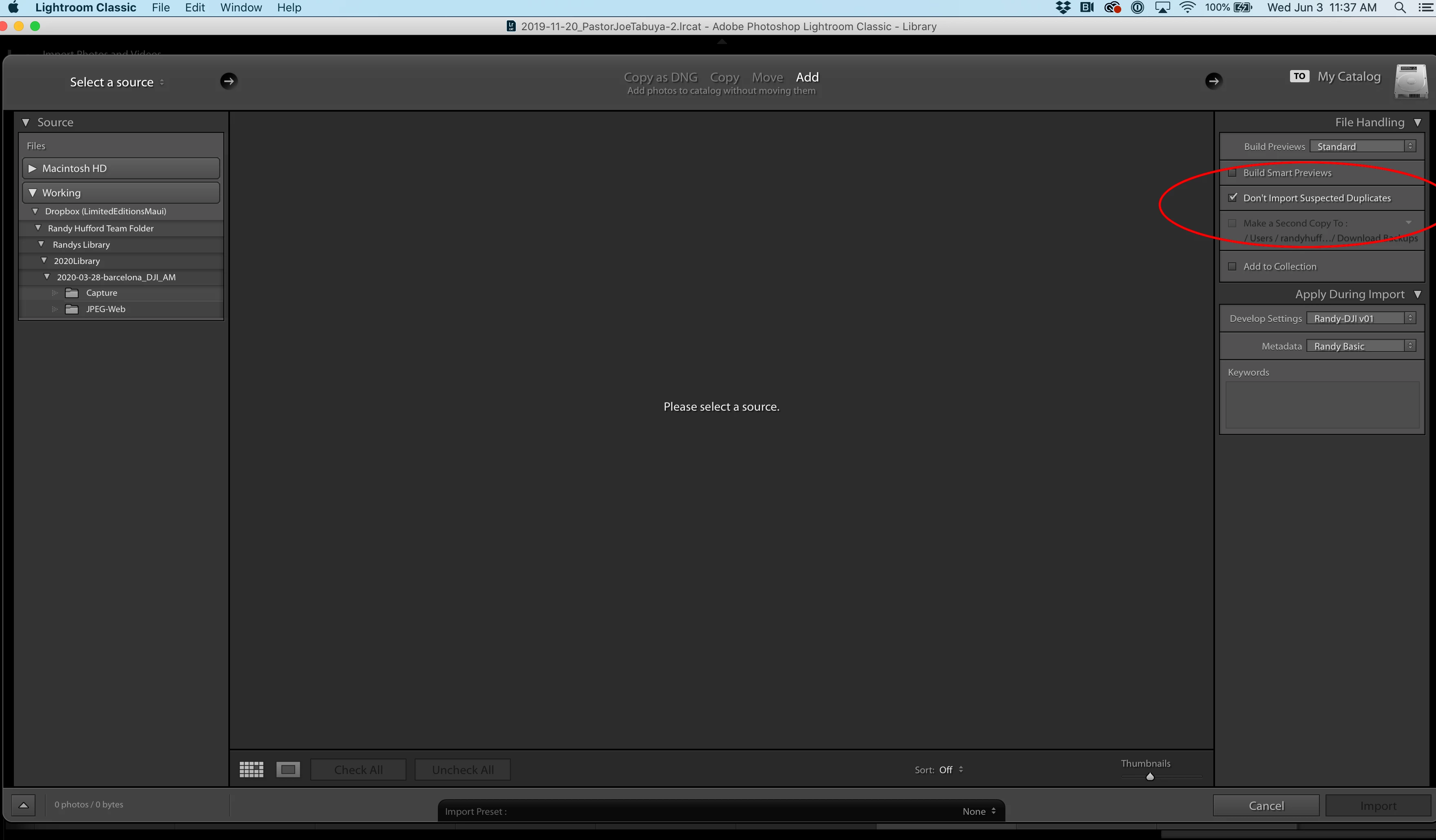

Are you sure you have turned off "Don't Import suspected Duplicates?" On The import dialog?

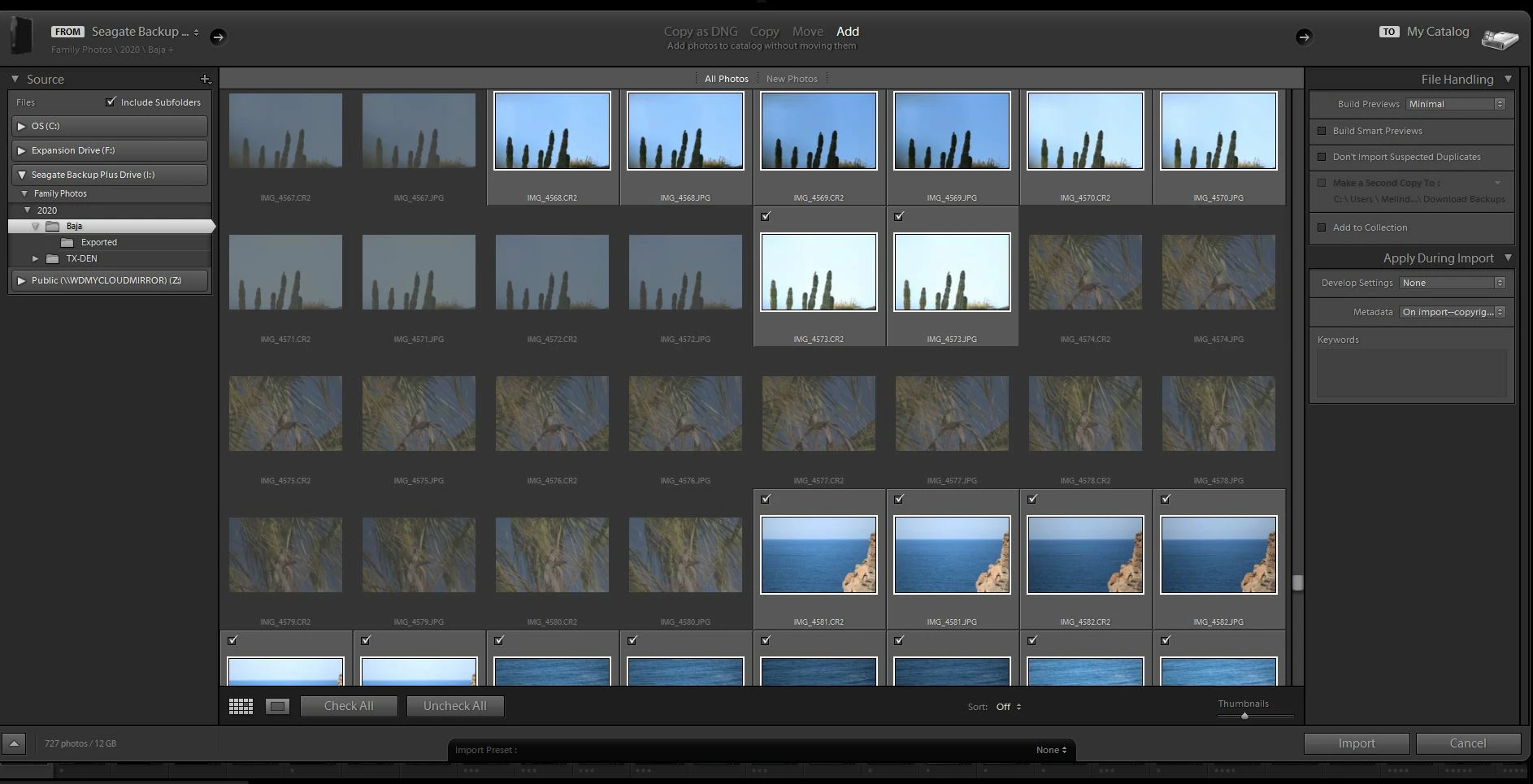

Hi Randy--
Yes. See the attached screen shot.  I played with this a little, and verified the images between the import dialog and my catalog.  What appears to be the case (new to lightroom, so believe me when I say "appears") is the following:
1) I don't know if you can see it but, for example, images 4573 and 4581 were 2 images I had removed from my catalog and they are available to be imported.
2) The images I'm interested in, and that are missing from my catalog, are 4574-4580, and they are not available to be re-imported.
3) They are behaving just as the photos in my catalog are, e.g. 4571 & 4572. So,  they must still be in my catalog somewhere and I just cannot find them?
4) I think I may not properly understand the "do not import suspected duplicates" feature.  It doesn't seem to make any difference if I check that feature or not, the same photos are available. Does it matter when that box is checked during the process?  Is it ever possible to import photos that are already in your catalog?  Maybe I'm not understanding how Lightroom defines duplicate.
