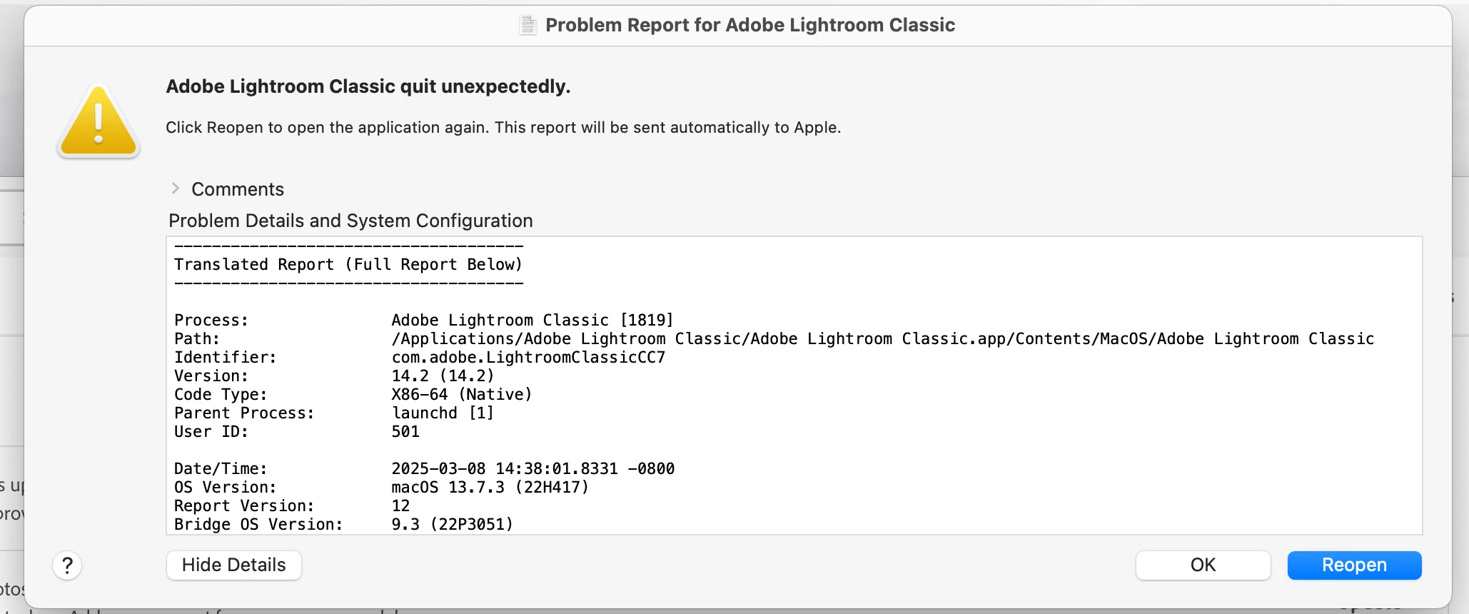

How to fix problem with app quitting "unexpectedly" each time I close the app. All still appears OK
EvEv
Every time I close LRC this happens. It began after the last update of the app. How can I fix it?

Aleke, Thank you for your reply. I updated to Sequoia and that solved the problem with Lightroom Classic.

Hi @JazzPurr10! Welcome to the community!
Thanks for reaching out and sharing the problem report dialog. We've seen similar reports from other macOS Ventura users. Getting the Apple crash window instead of the Adobe one suggests this is an issue with Apple, so there's not much we can do on our end.
Could you try updating to Sonoma or Sequoia and see if that helps?

Alek,
Thank you for the suggestion. I've put off updating to Sequoia as up to this issue started, Ventura has been just fine. Will update tonight and see if it solves the problem.
