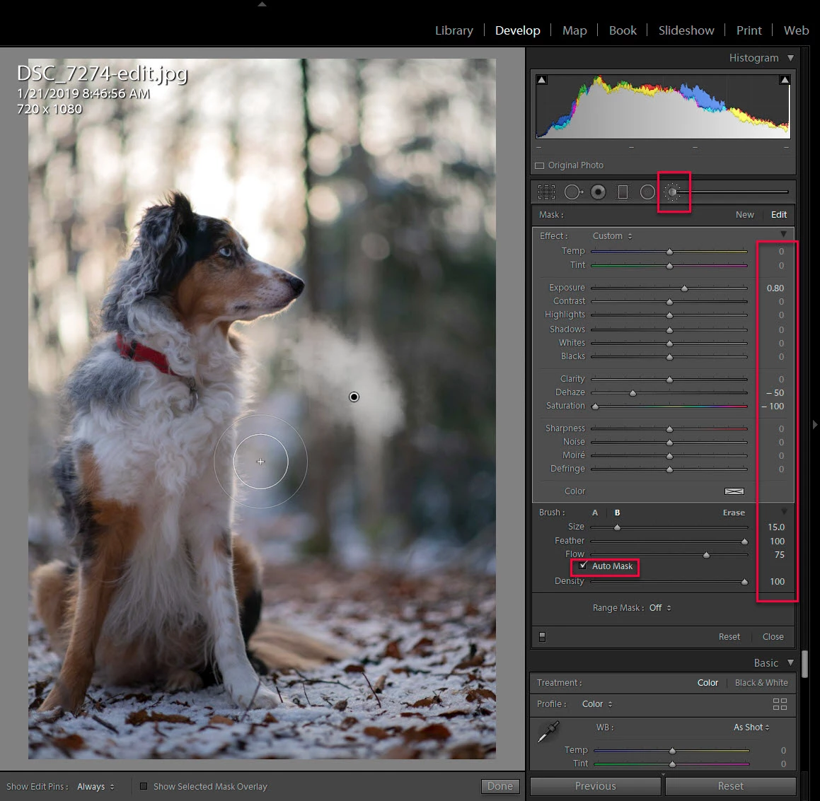

    Elaborating on suggestion try using the Adjustment Brush with the below settings. You may need to increase the brush 'Size' so that it's close to what's shown below. Start brushing in the middle of the visible breath area to establish it as the target. Keep brushing over the area until you achieve the desired size and density of the breath fog. Then adjust the 'Effect' settings for more control. Save these settings as an brush preset for future use. Cute dog!
