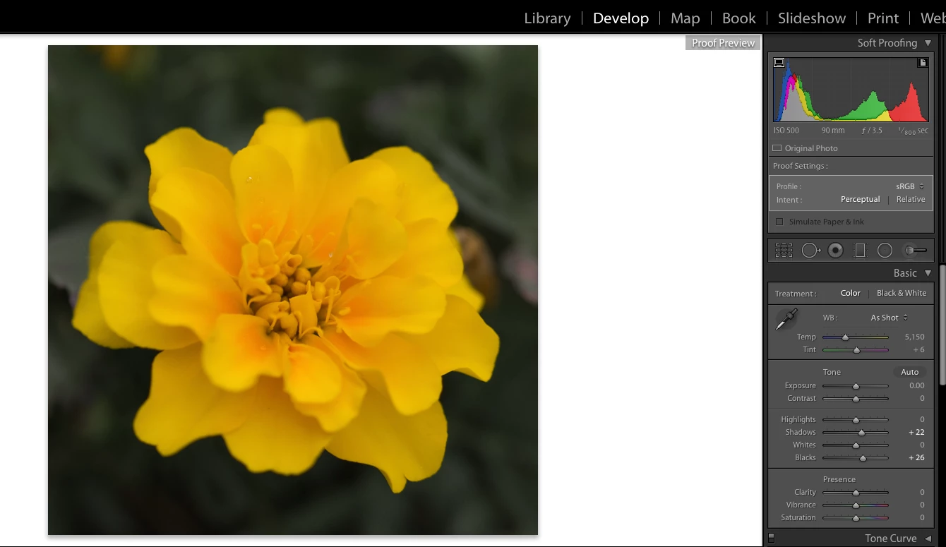

can someone point me to a tutorial for LR so i can better understand out of gamut color/ blown color chanels? i als need info on the numbers and what they mean.
for instance if  I have a yellow flower and the numbers read       R 245    G 182      B 0    what is that telling me?
I know their is a short video here that Julian kost did but it is not detailed enough. THANKS!

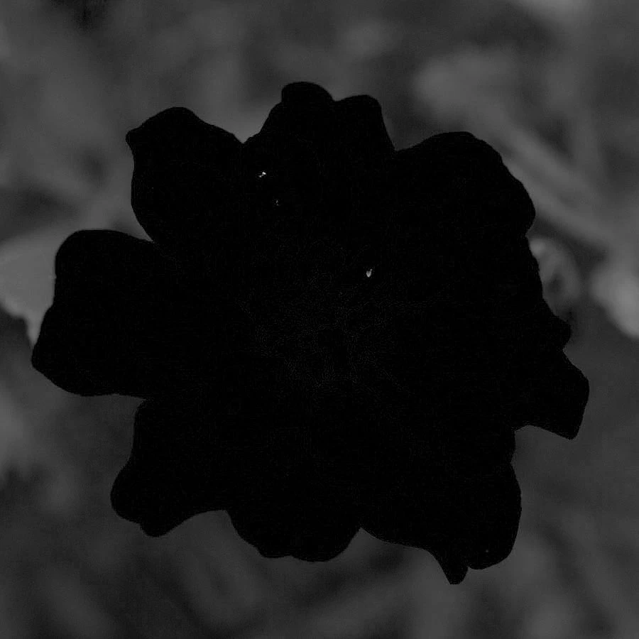

    There's no major blue clipping here. The narrow blue spike at 0 isn't a problem as long as this is just a one-off sRGB export.
    Pulled up in Photoshop, this is how the blue channel looks:
    As you can see, there are no solid black areas, just specks of noise and this is what causes the spike. I wouldn't worry about this.
    The high end is nicely kept in sRGB gamut.

    so here is my problem this image is within gamut according to the soft proofing for screen, that is what i need, but I'm constantly being told it is out of gamut and there is no detail. I know the focus is soft that is not my worry.
    they are only looking at it and do not pull it into lr to check.
    what is your opinion! is it in ok or do i not know what im doing? I added the histogram also below. Please help! I'm lost!
