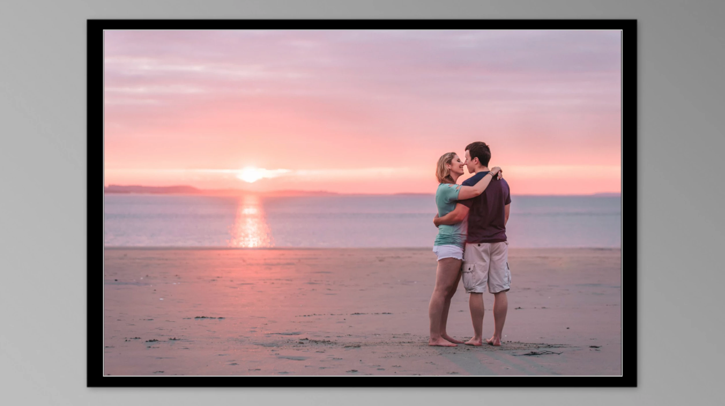

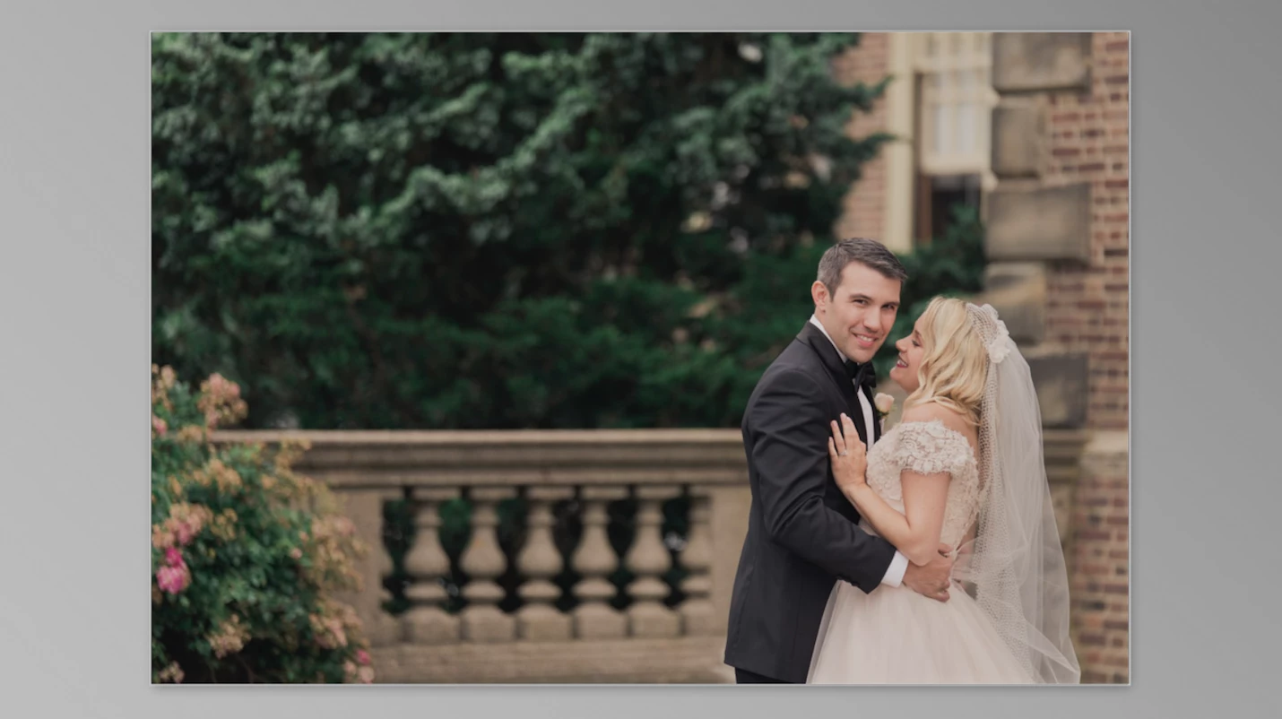

When creating a slideshow in LR CC Classic (fully up to date, 7.1), some images have a black 'frame' around them. It looks to me very much as if it's a space filler. I have the feeling some images are smaller than others and the smaller ones have that black frame around them. And all of this relates only when viewing the slideshow in full screen mode. What's the solution?

It looks to me like the one with the black frame is too small to fill the window. Is it possibly a low resolution image?
Theresa I thought the same thing and tested this on my system. Even with a small image, pixel Width & Height, no black frame was shown.
I thought it might be the OP had set a Background image that was all Black but I never tested that.

Just Shoot Me​ a background image would fill the area that is now grey in the OPs screen capture. The black appears to be inside of the frame area of the image. That’s the curious part. I have never seen this before.

It is a setting in the Slideshow module. Stroke Border.

The Stroke Border is actually the thin white line that goes around both images. In addition though there is the black part in the lower image...

Then check the Background Color.
