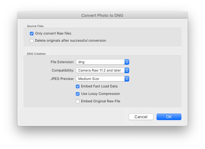

Correct answer Jao vdL
>my question is, if there is a way to do what i want to do: reduce certain image files in size (small dng or jpeg), without loosing the refernces to the collections.
You can't replace raw files by jpegs in place. There is no way to do this in Lightroom. What you can do to save space however is convert those raw files to dng. This will usually save quite a bit of space and you can even convert to lossy dng which will reduce the size to something close to jpeg but with all editing options still intact. Those are way better to keep than jpegs.
You do this by selecting the images you want to convert and from the library menu select "convert Photos to DNG". You will get a dialog like this:
Normally you would not select "Use Lossy Compression" but you probably want to in this case. You can also select "Delete originals after succesful conversion". If you don't you will have to manually delete them from the folders they are in. Just tested this and this turns losslessly compressed NEF files of around 30 MB each into dngs of around 6-7 MB each but retaining all editing options. Doing this should keep the images in any collections they are in.

Jao vdLCommunity ExpertCorrect answer
December 27, 2019
