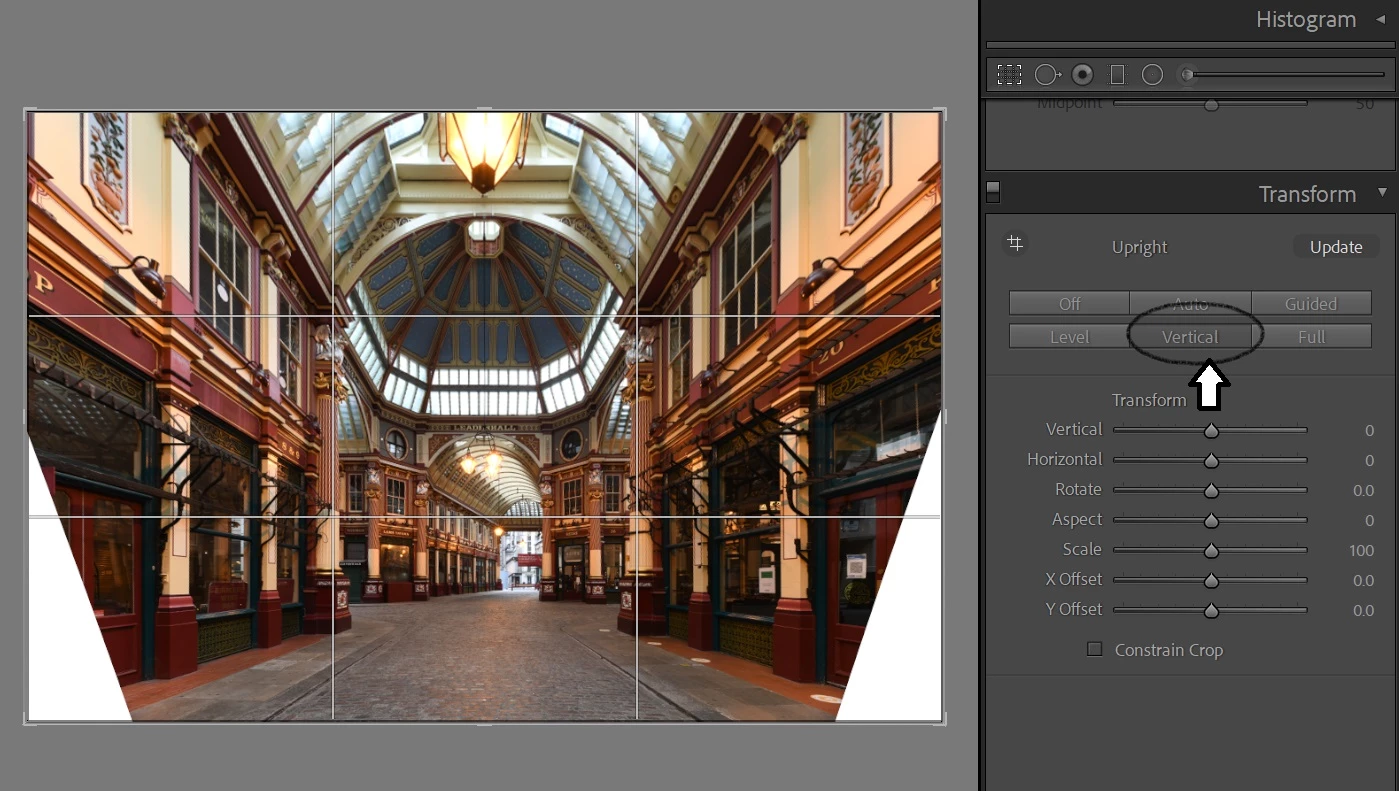

  • Go to the Transform tab
  • Select the most suitable straightening tool for your image
  • In this instance I selected the Vertical straightening tool
  • Use the manual sliders below to make any adjustments if required

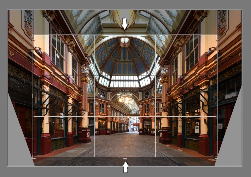

Important settings for cropping
  • Set the Aspect Ratio to 'Original' so your image keeps its original dimensions
  • Ensure the padlock is closed on the right hand side
  • Select the Crop & Straighten tool on the left (small rectangular box)
Cropping your image
  • Straightening a tilted angle vertically will mean you lose the corners of your image. These corners will be replaced with a blank white area
  • Use the Crop & Straighten tool to crop your image so you lose those white corners out by dragging the edges of the grid to where appropriate
  • Click 'Done' when you are happy with your crop to see the final result. You can chop and change as much as you like
  • As you can see below I've managed to keep the top of the dome in shot as well as lining the bottom of the walls up with the corners

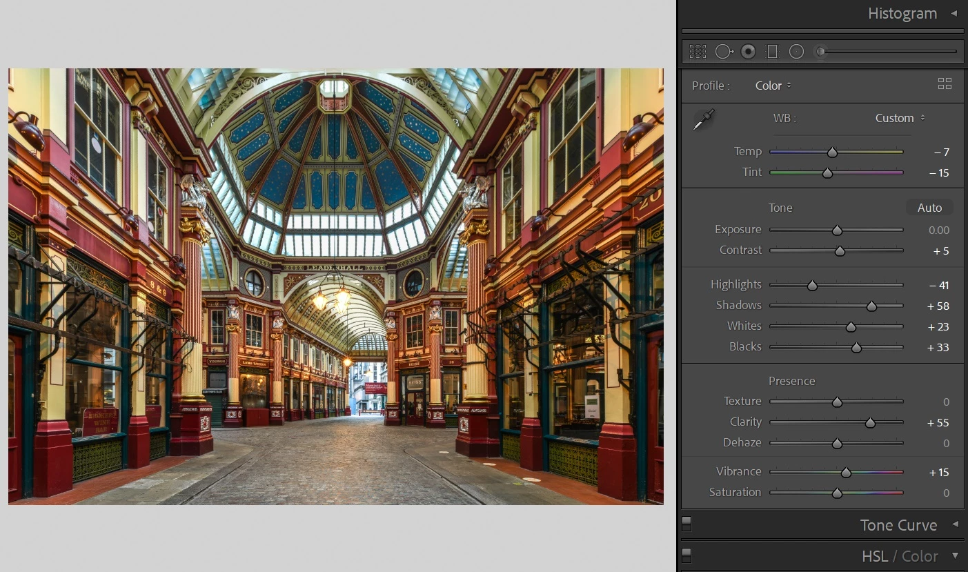

❺ Edit your image

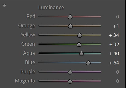

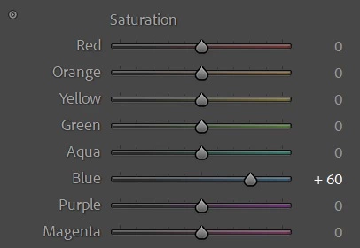

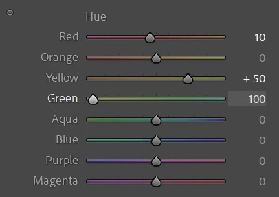

  • This really comes down to personal preference. For this shot, I took out some of the shadows, upped the clarity, dropped the highlights, and played around with the colours to adjust the white balance and make certain colours pop such as the blue ceiling in this case
  • See my settings below
