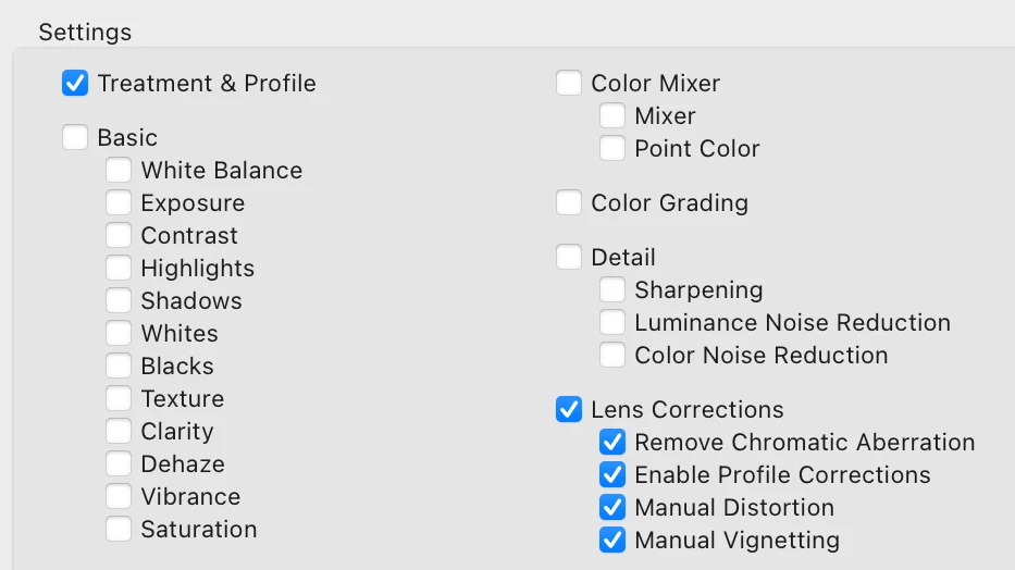

4. In the Presets panel, click + > Create Preset, check just the boxes Treatment & Profile and Lens Corrections, and save the preset under the name "M10-R Defaults".

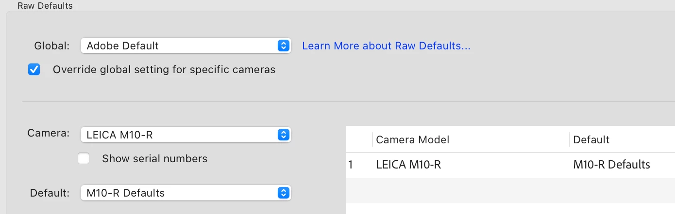

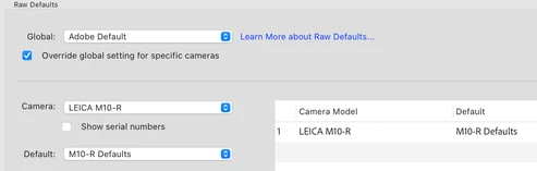

5. In Preferences > Presets, check the option Override Global Setting For Specific Cameras and set the preset M10-R Defaults to be the default for the M10-R:
Now, when you import raws from that camera or click the Develop Reset button, the profile will default to M10-R and lens corrections will be disabled.

4. In the Presets panel, click + > Create Preset, check just the boxes Treatment & Profile and Lens Corrections, and save the preset under the name "M10-R Defaults":
