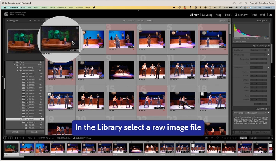

❶ Open a raw image
  • *Note - Only Bayer and X-Trans raw files are supported at this time (which includes most popular raw file types.)

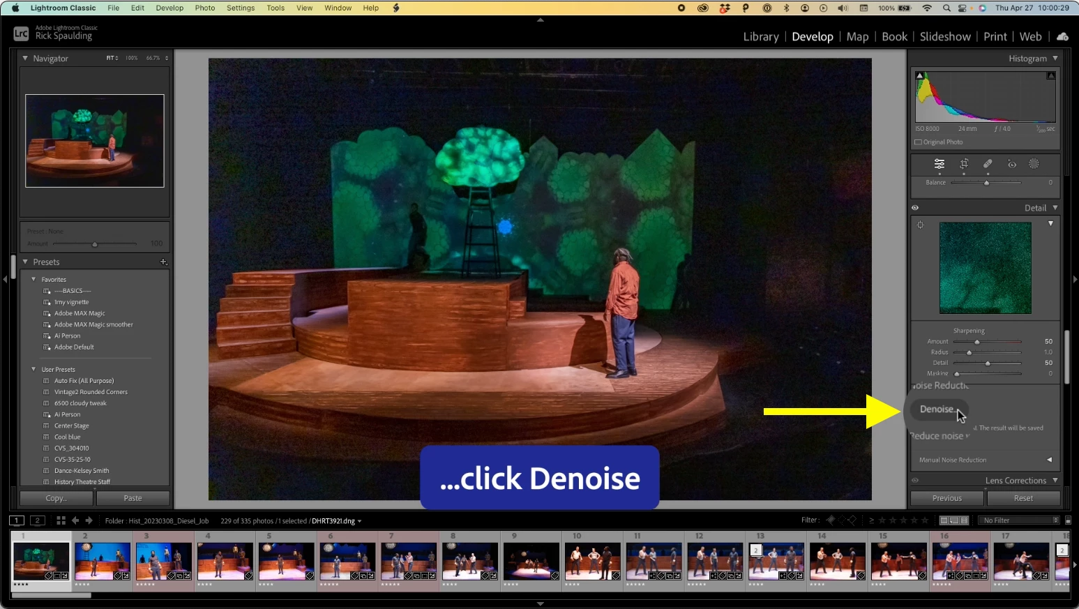

❷ Select Denoise
  • From the menu bar, select Photo > Enhance or select Denoise in the Detail panel.

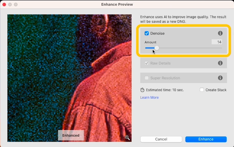

❺ Set the filter strength
  • Use the amount slider to change the intensity of the filter.

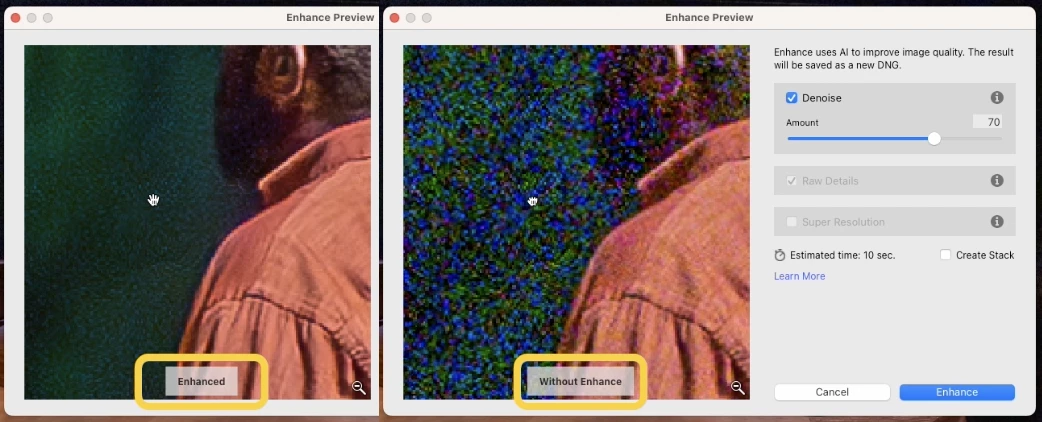

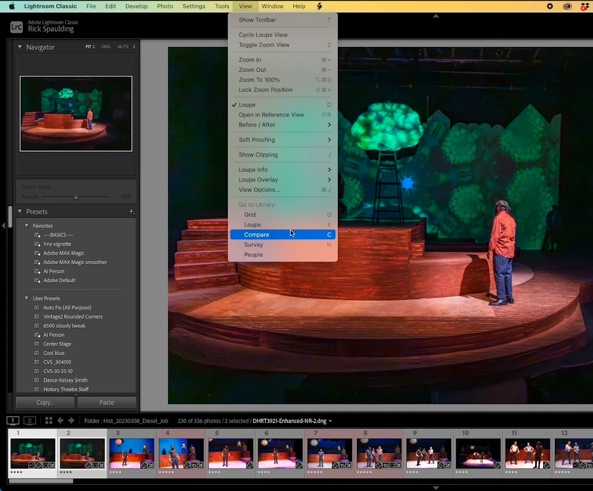

❻ Preview before and after
  • You can press and hold the preview image to see the effect.
❼ Click 'Enhance'
  • Click Enhance to generate a new DNG file.
  • Enhance-NR will be appended to the filename and it will appear next to the original or stacked depending on you choice.

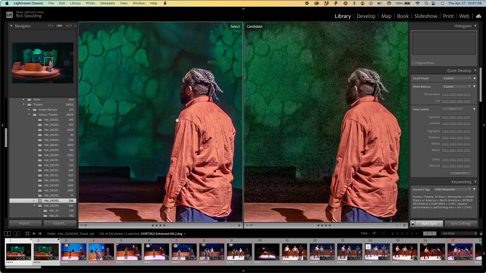

❽ Compare your results
  • Select both images and click View > Compare to see the results side by side.

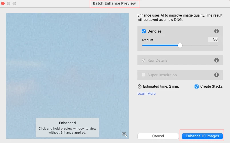

I'm looking for advice if I could sync Denoise function and apply it to batch of images from the same series. For example when creating a timelaps video I export 300+ images with the same settings. Should I end up with hundreds of DNG files, set manually one by one or there is another way to do that? Thanx!
Ian Lyons
September 10, 2023
You can select a batch of files in LrC grid, choose Enhance > Denoise, adjust the Amount slider of previewed file to taste, then tap the the Enhance X Images button as shown on attached screenshot.
Note that denoising 300 files in one batch will likely bring your system to a standstill, if not worse. Best you break process down into much smaller batches (e.g. 20 files).
