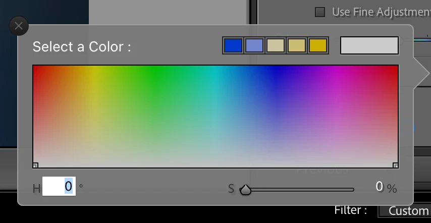

Rikk Flohr_Photography
July 13, 2023
H and S are both clickable in the Color Swatch Picker and values can be entered.

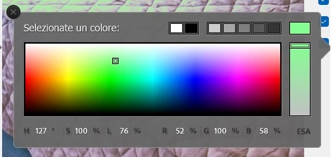

FabioC.
July 26, 2023
Hello  Rikk,
As you can see in this screenshot this is a plugin that allows to read HSL and RGB colors together.
Can this feature be implemented directly in LrC?
As well as the ability to change the HSL and RGB values.
