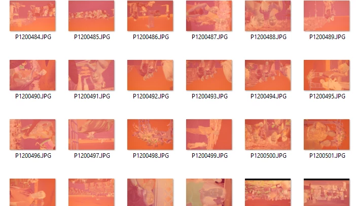

April 26, 2021
It appears you are capturing the negative film using a Panasonic DMC camera. However, it looks like you also have the camera set to JPEG output. You should be using raw RW2 file format. Either way the camera captured film image files will only show the Negative Lab Pro (NLP) eidits from inside LrC because it uses non-destructive editing. Those edits are saved in the LrC catalog file and only applied to exported files or Edit in PS files. You will need to export the original NLP edited files to JPEG or TIFF file format and then run face recognition on just those files.You can do this by exporitng them to a separate subfolder or by exporting them to the same folder as the orginal files and using the filter bar to show just the exported JPEG image files. Then use Face Recognition set to 'Only Find Faces As-Needed' mode with those files manually selected. There may be some other "tricks," but I don't use face recognition so the wrong person to ask.

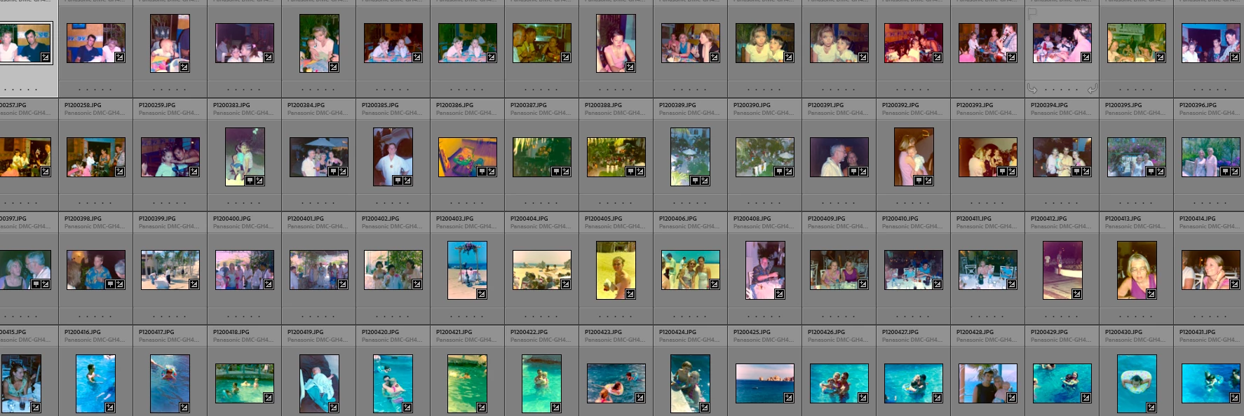

Todd I am not very good at describing the problem.
Here is a view of how the developed negatives appear in lightoom
Here is a view of how they appear on my hard drive
The face recognition system cannot work with these negatives.  So the work around is to export these photos from lightroom wich will   export the positive image, then reimport them to light room which puts the positive in place of the negative... At least that is what I think happens. I have not as yet tried it. Then the facial recognition system will work and the negatives are then lost. I think I might have to confine all of this to the negative files on my hard drive.
