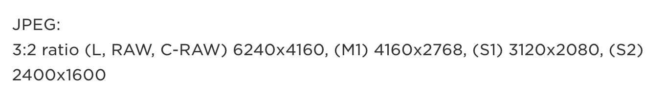

Here is the file specs for the Canon RP although you have never said which camers you are using.  Depending on what camera you are using the specs may be similar.  Are you sure you are not shooting at S1 and think you are shooting at M1 JPG files.  The sizes match your description
EDIT.  I forgot to attach the specs

Thank you everyone for providing possible reasons. I was shooting in M Raw + M Jpeg which should have resulted in a similar resolution for raw and jpeg. But after checking raw image size as suggested in one of the responses, I saw the resolutions were lower. One thing I did immediately is checking it again and it produced the same results. But after doing a firmware update (which was pending for a long time and I tried a beta toolkit on the camera), the issue got resolved. It had nothing to do with lightroom export but was due to how the images were captured (should have cross-checked that). But thank you everyone for responding and helping out.

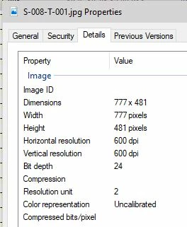

I think the confusion is what you may see in the file properties (Explorer or Finder). In Explorer (Windows) both pixel size and DPI are dislay which is confusing (at least I found it). So, I did a test.
I took an original 4928x3264 RAW file and exported it from LR as JPG 3 times.
  • The original size and I specfied the Resolution 111
  • Reduce to 2000x1325 pixels with a Resolutuion of 112
  • Reduced to 800x539 with a Resolution of 113
The result is that each had the correct pixels in the image and DPI was what I set the resolution at as seen in Windows Explorer.

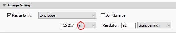

I believe 'Resolution' is only relevant when your output size is in a external size measurement like inches or cm's. I've always wondered why it's always presented as option for all sizing choices.

Sometimes a particular Resolution figure is specified by the recipient, who you will be sending the image to. Sometimes their own software workflow might treat an image differently, depending on the PPI number, even though it consists of the same number of pixels. And they don't want to have to change that PPI themselves, before using your image.
Even if it is not affecting that number of pixels that will be included - nor the end usage - and even if you are not Resizing the image in any terms - still LR has got to set some PPI number that the output should be labelled with. That is a compulsory part of the image format. It cannot be left "blank" regardless how little interested anyone may be in this - for example, when the image is purely destined for viewing on screen.

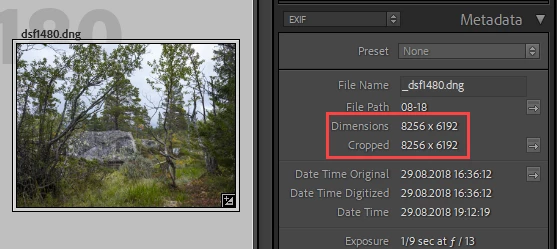

January 25, 2021
With the image selected in Library, what pixel dimensions does LR report?
