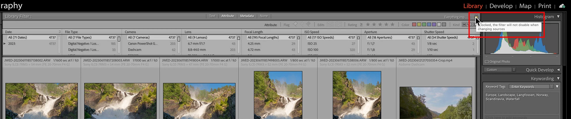

This is a FAQ. The denoised image inherits the rating, or at least it should. That is not the reason the filter is reset, however. The filter is always reset when a new image is generated, to avoid confusion if the new image does not fit the filter criteria and so it is filtered out. People may think that denoise did not work at all if they don't see the result. To stop the filter from being reset, click the padlock in the upper right corner of the filter bar.

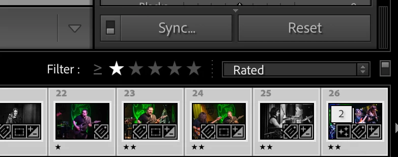

Thank you for the update. I did see that FAQ but I could not find the lock option, here is a screenshot.

February 18, 2024
That's the filter bar in the film strip. You need to go to the filter bar at the top of the main Library module window. Press the backslash key if you not see a filter bar there.
