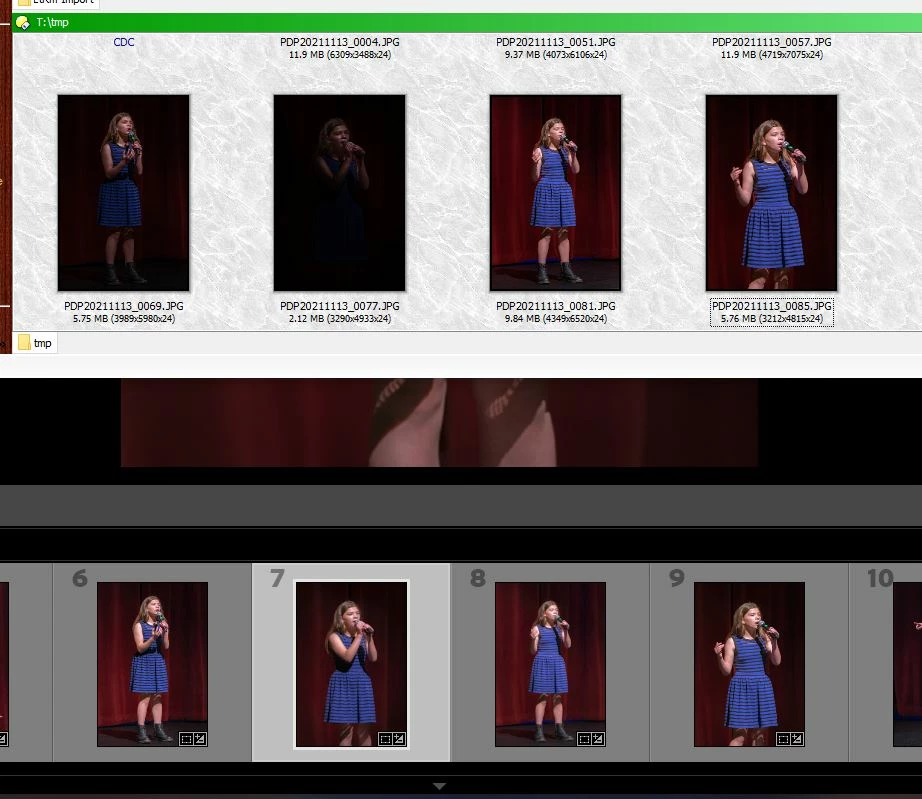

Since updating to latest versions with mask enhancements, some of my images are exporting with significant dark overlays which seem related to linear masks.  See attached example.  The top set of images are how the four were exported.  The same set below are how they appear (correctly) in LR.  Strange thing is that the last two images of the four look correct, but have the same type of masks as the other two.  Second attached screen cap is of the worst of the four, showing the two masks.

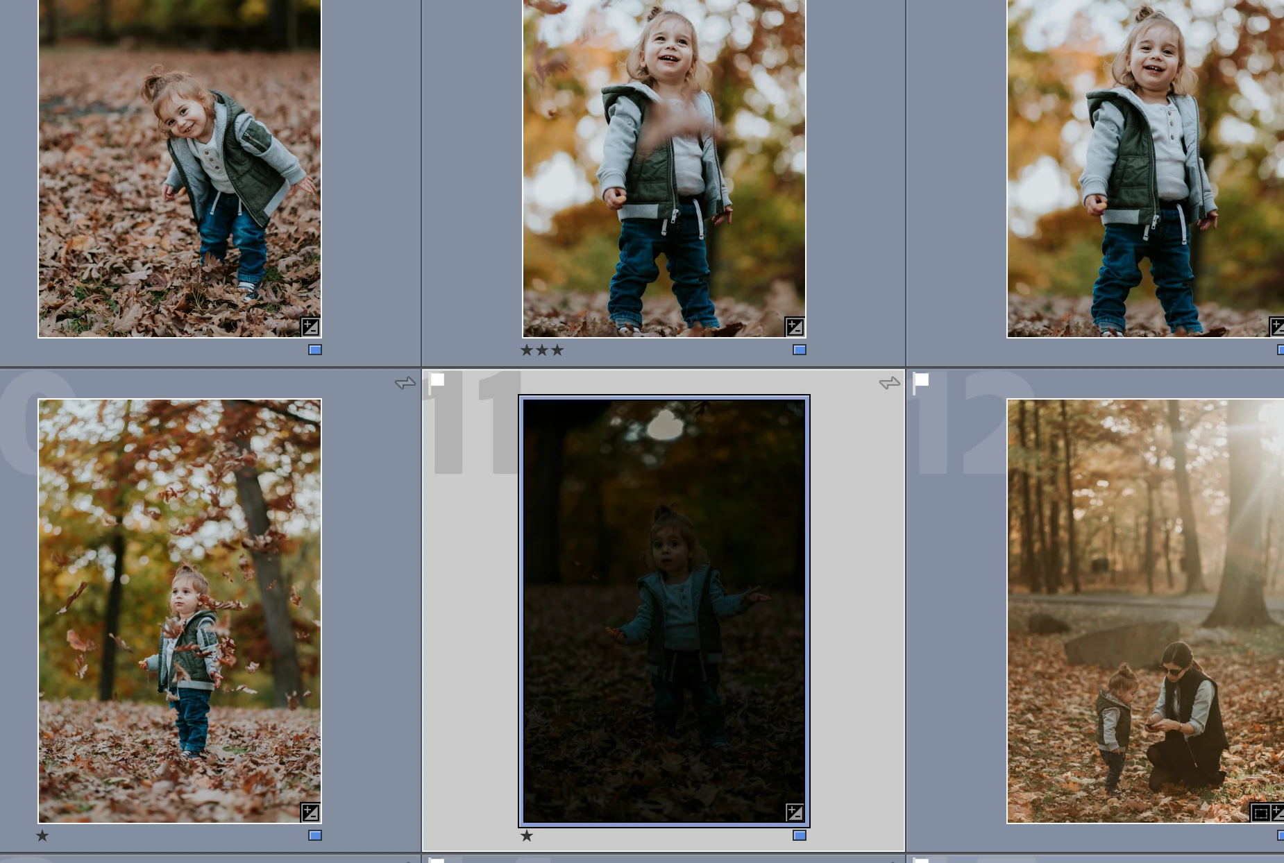

I just had this same issue occur to me. Has the root cause and resolution been found? At first the selected photo would export signifigantly darker than the surrounding images but were shot at the same camera settings and had identical edits. At first it appeared like the other photos and only showed up dark once exported. Once I built the 1:1 preview for it, it showed up dark in Lightroom as well.

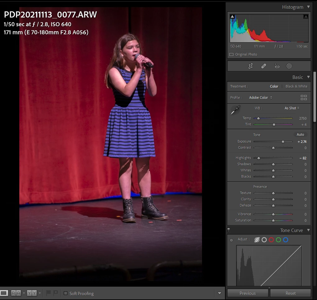

I have reduced the problem to the Exposure and Highlights sliders.  Load the supplied .ARW image, set the exposure level to 2.75 and the Hightlights slider to -84, then export.  It will be much darker than in LR.
Files:
Image: https://www.dropbox.com/s/mozz19iq4v4tstt/PDP20211113_0077.ARW?dl=0
XMP file: https://www.dropbox.com/s/y65t46a3s3f196f/PDP20211113_0077.xmp?dl=0

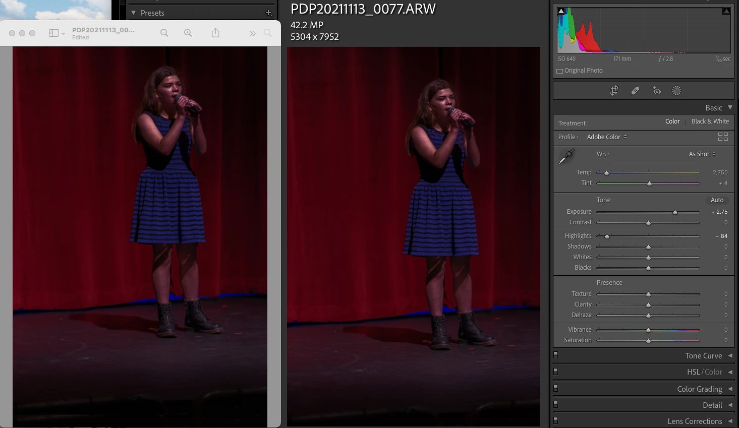

I don't see that with the .arw and .xmp you supplied. I made the changes to Exposure and Highlights and exported as JPEG, and on my LR 11.0.1 / Mac OS 11.6 the exported JPEG (left) looks nearly identical to Develop (right):
Usually when there's a large discrepancy between Develop and exported images on Windows, it's one of two things:
1. Using a non-color-managed viewer app. I don't recognize the app you're using in the screenshot -- what is it?  Firefox, Irfanview, and Faststone are three free color-managed viewers (Google Chrome still has bugs, last time I checked) (you have to explicitly enable color management in the latter two).
2. A color display profile that either doesn't conform to industry standards (fairly common on Windows) or is incompatible with LR (e.g. a version 4 ICC profile). You can quickly test that following these steps:
https://www.lightroomqueen.com/articles-page/how-do-i-change-my-monitor-profile-to-check-whether-its-corrupted/
Paul Peterson
November 22, 2021
Thanks, John.  My external viewer is the Directory Opus utility and has not been changed since things were looking correct.
Your in-LR rendering doesn't look like mine, here:
Mine looks more like what you'd expect for a dim original image with exposure boosted and highlights lowered.  I'm surprised a how your's rendered so dark.  I have changed no monitor settings or color profiles.  Only change was the upgrade to v11.  Things have worked great till I started doing the exports.
