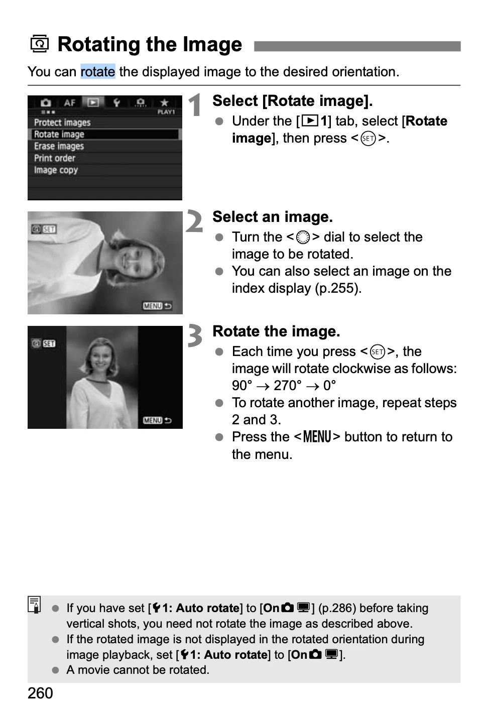

Did you Rotate the image using Image Playback in the camera.  Maybe that causes issues.   This is from the 5dMark3 manual

February 24, 2023
No, I didn't Rotate the image using Image Playback in the camera.
